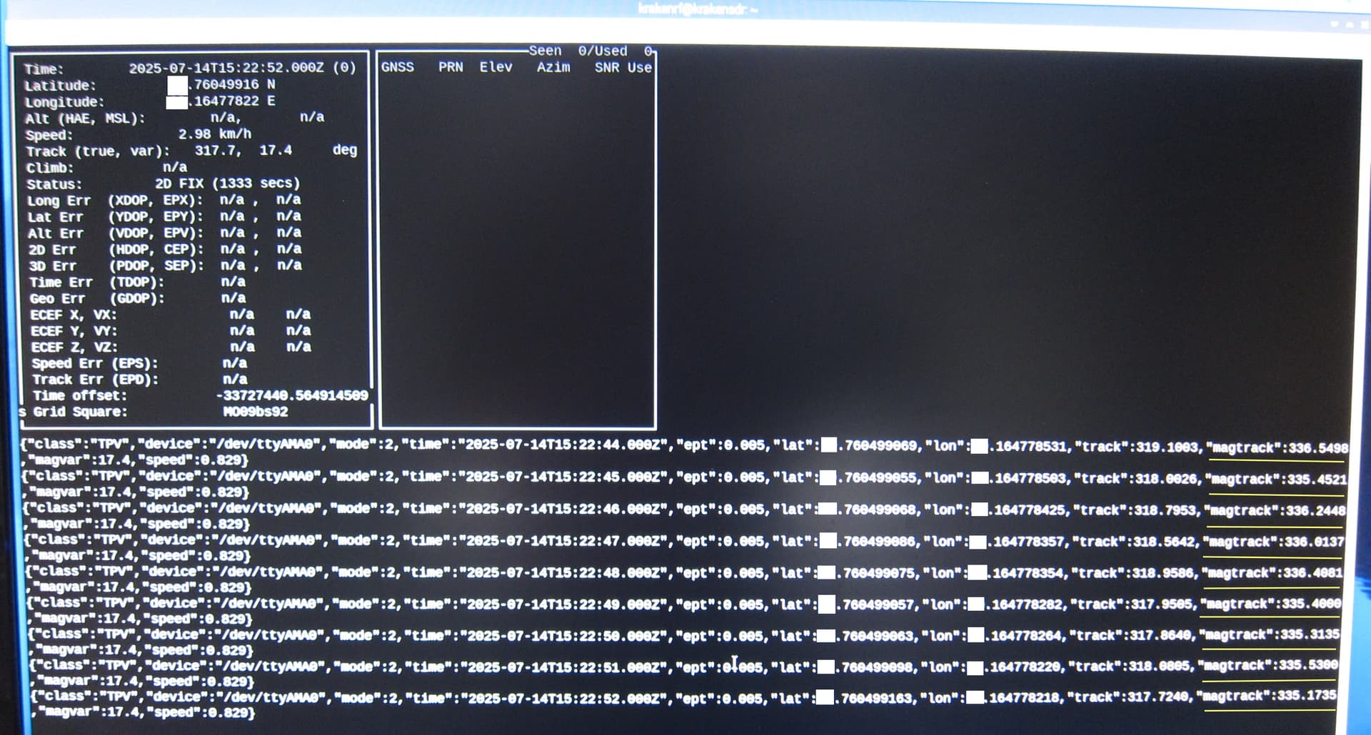

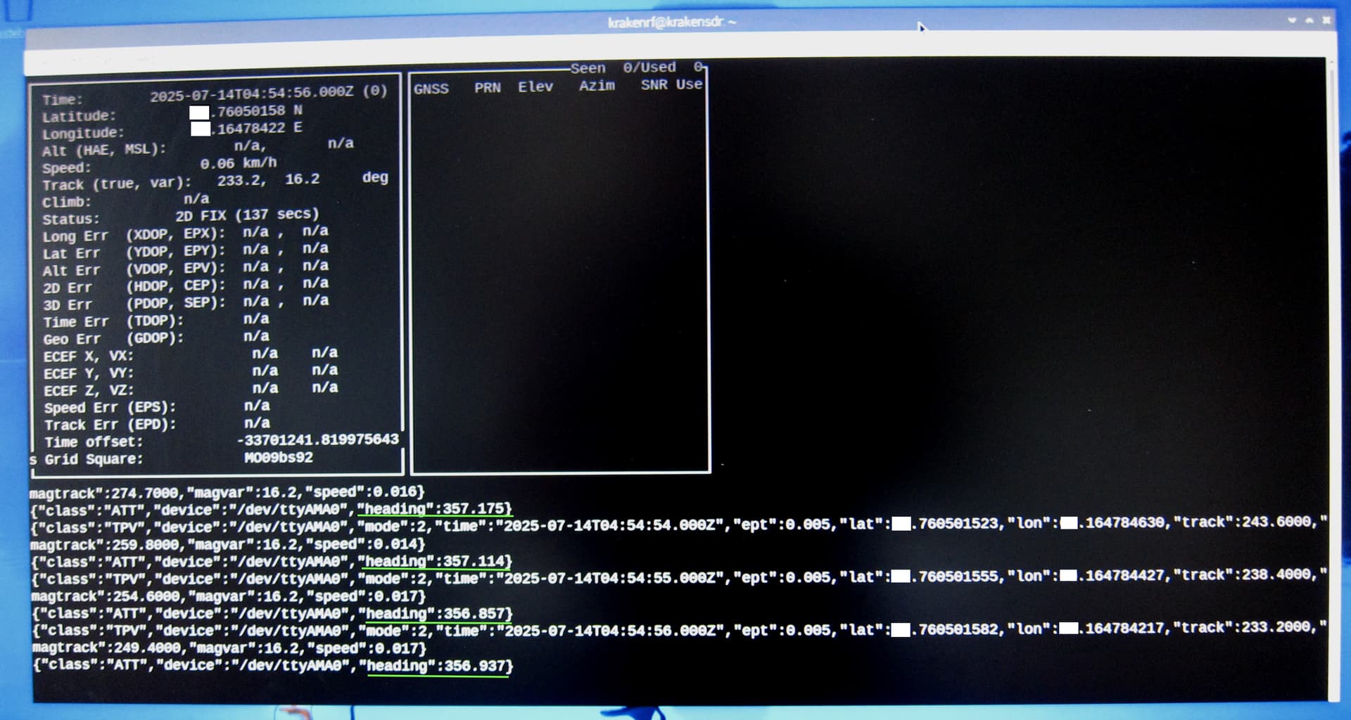

All the software developers’ decisions for Raspberry Pi and Android were based on the need for a car to move. But today is the middle of 2025. GNSS models with the heading function have appeared on the market. I bought a GNSS modul UM982 and two spiral antennas GNSS HX-901 (or two spiral antennas GNSS HA-609). If these antennas are placed at a distance of 1 meter, the module is able to provide heading with very high accuracy.The UM982 module is easily configured using the PC software. I have configured NMEA output of messages like $GNRMC and messages like $GNHDT. Next, connect the UART on GPIO header inc 8/10 (GPIO 15/14) Raspberry Pi 5.
The GPSD service normally receives these messages.
So what’s the problem? Why can’t you make changes to the program to directly transfer these heading values to the web interface and to the Androin application?
P.S.: I have not activated all other messages in the UM982 module.They are not required for this experiment…

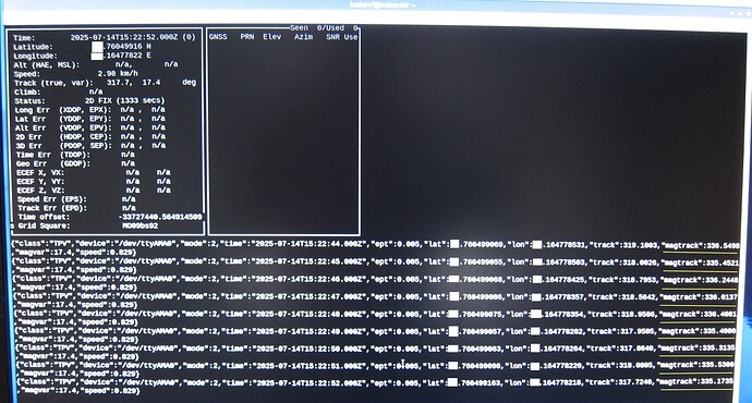

I continued experimenting, and imitated a message like $GNHDM. Again, the GPSD service receives my messages well and recognizes the magnetic track. But this data is also not transmitted to the web interface and to the Android application. This means that any magnetic compass will not work with the krakensdr. If the truth heading $GNHDT and the magnetic track $GNHDM are well received by the GPSD service, but this data is not transmitted to the web interface and to the android application, how else can this data be transmitted to the web interface and to the android application???
I’ve read all the forum posts about heading. All the recommendations and tips are something like this- we don’t know which compass to use, we’re not sure if the GPSD service will work with your GPS and your compass. Now that it is clear that the GPSD service accepts both “true heading” and “magnetic heading”, what else can be done to ensure that heading is transmitted from raspberry pi 5 ?

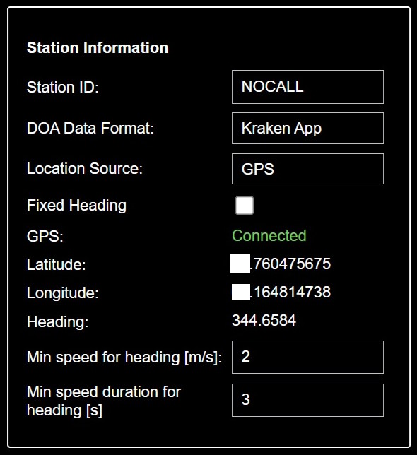

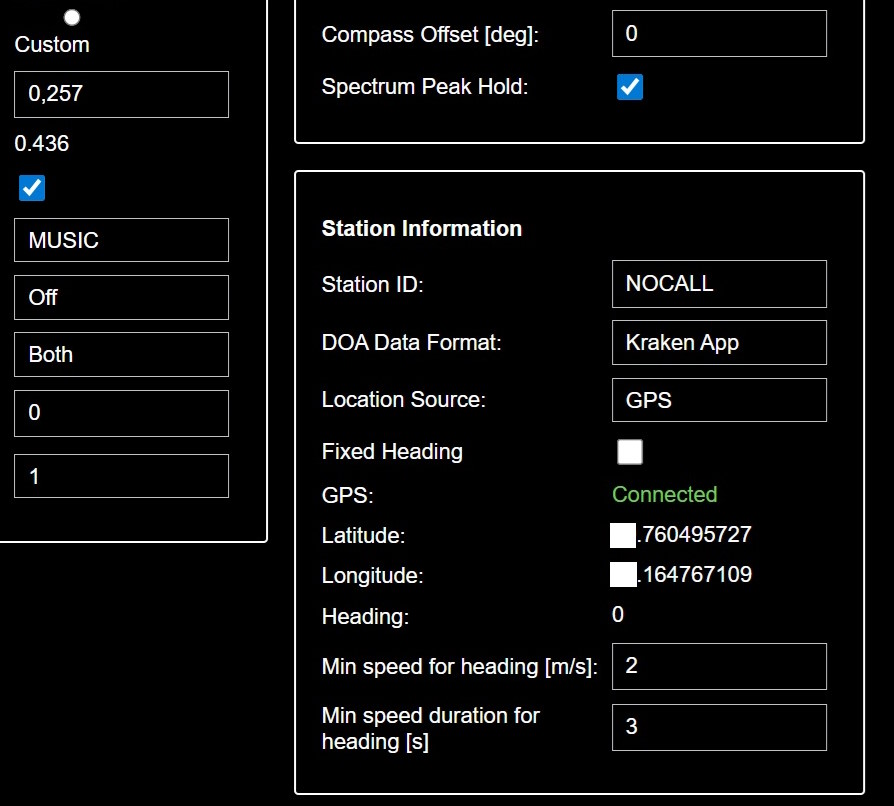

Greetings to all kraken users. The discussion about heading and the magnetic compass is already very old. But this issue remains unresolved. So I solved this problem on my own. This is not a ready-to-use solution. I’ve never used raspberry pi before, and I’ve never written python code. Nevertheless, in two days I was able to figure it out enough to do it my way. In short, I had to programmatically replace the field in the NMEA sentence. I took the data from the “heading” field of $GNHDT (or $GNTHS), and inserted this data into the “track” field of $GNRMC. Next to the file "kraken_sdr_signal_processor.py " added two lines and changed one line. Now, using the compass described at the beginning of this topic, I get the “heading” change in the Android app. I am very pleased with the result, and now I will try to output this data to the web interface. I will also try to use $GNTHS directly without replacing fields in $GNRMC.

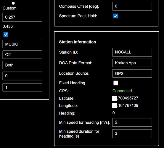

Today I was working on improving DATHFK_soft. My concept is to completely abandon the “track” when the car is moving and use only True Heading. Now, regardless of the movement of the car, there will always be the correct heading.Today’s work on DATHFK_soft has brought the following results. True Heading is now transmitted to both the web interface and the Android app. So far, everything is working well, and no bugs have been detected (in fact, there are always bugs, maybe I’ll find them later).When I have free time, I will continue to work on DATHFK_hard and DATHFK_soft. I have a work plan for the device and possibly in the future for other additions such as “Pickle button for jammer hunting”…

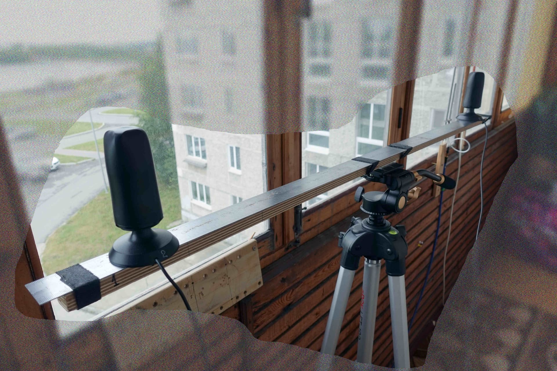

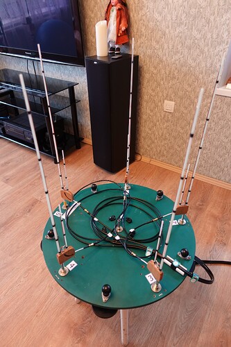

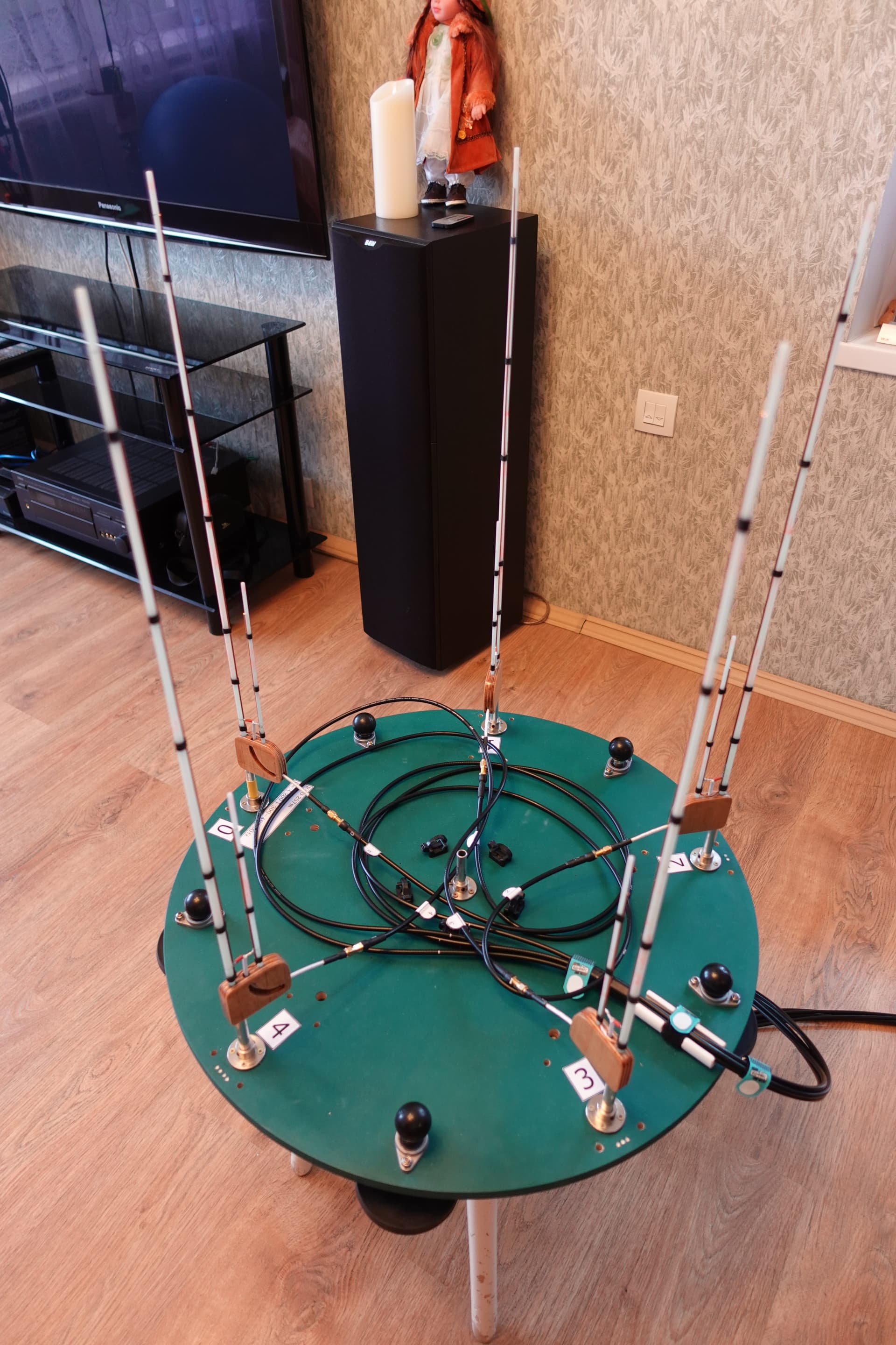

My equipment…

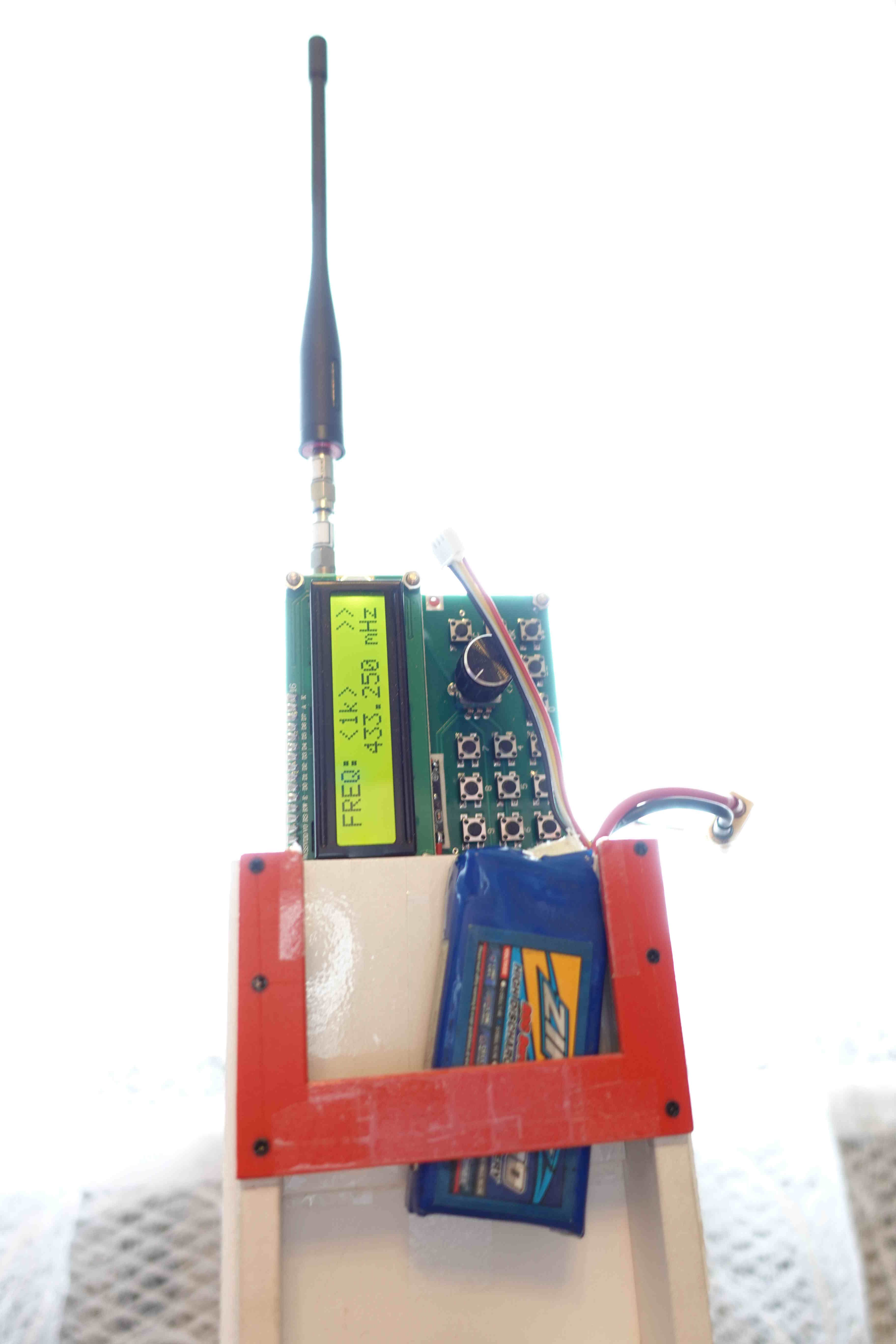

test transmitter
kraken antennas J-pole 433MHz
Two spiral GNSS antennas on a magnetic base.

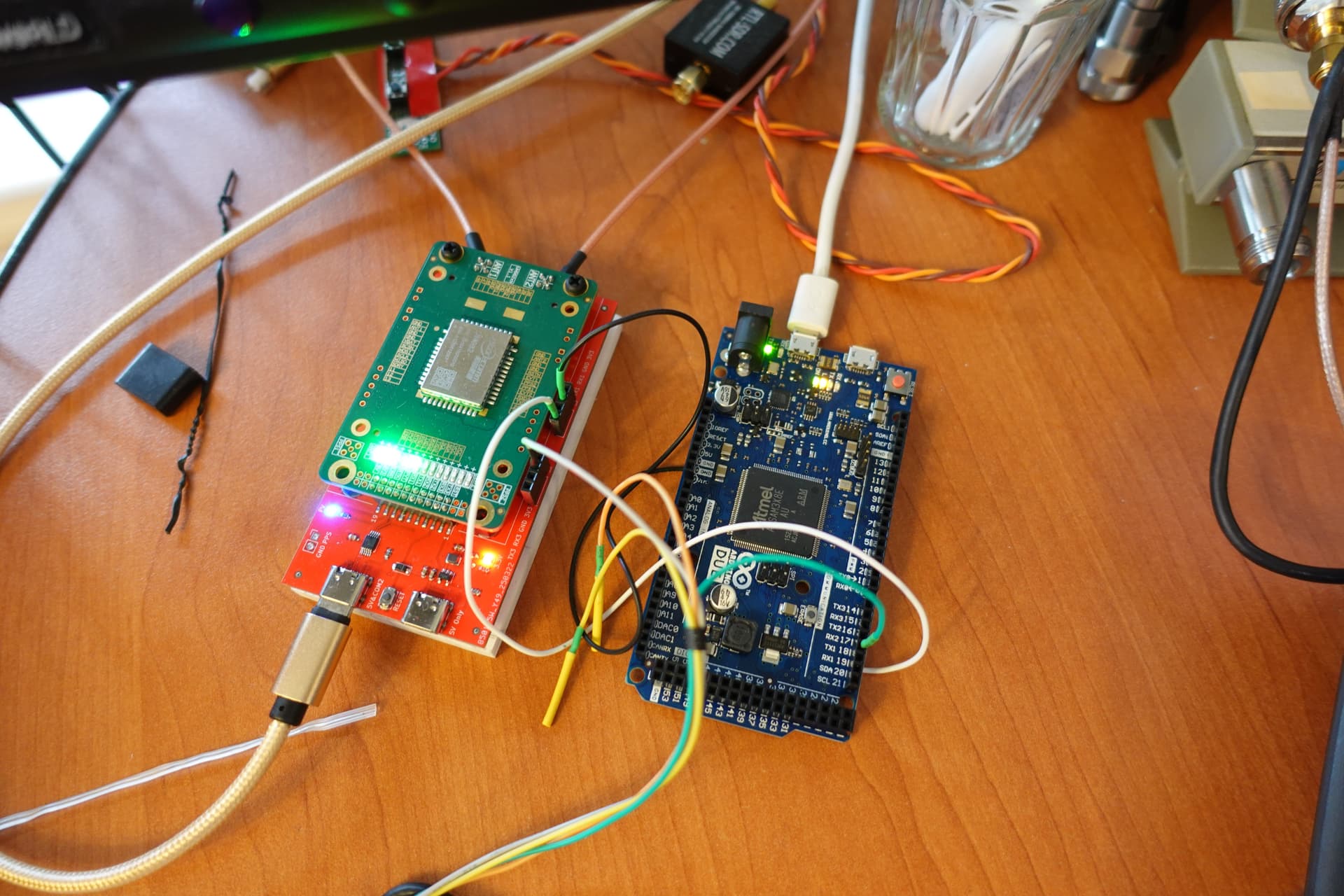

DATHFK device prototype

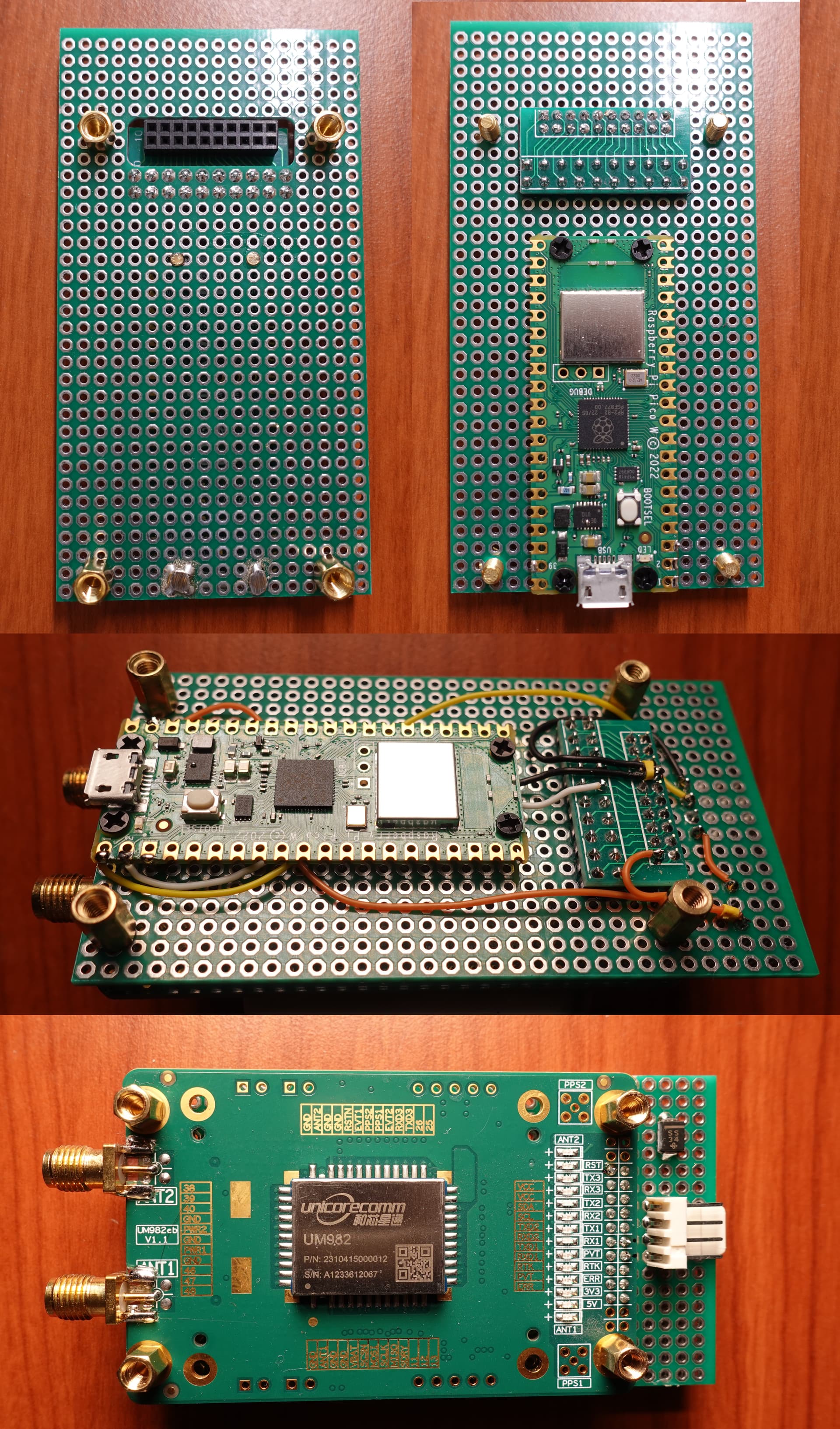

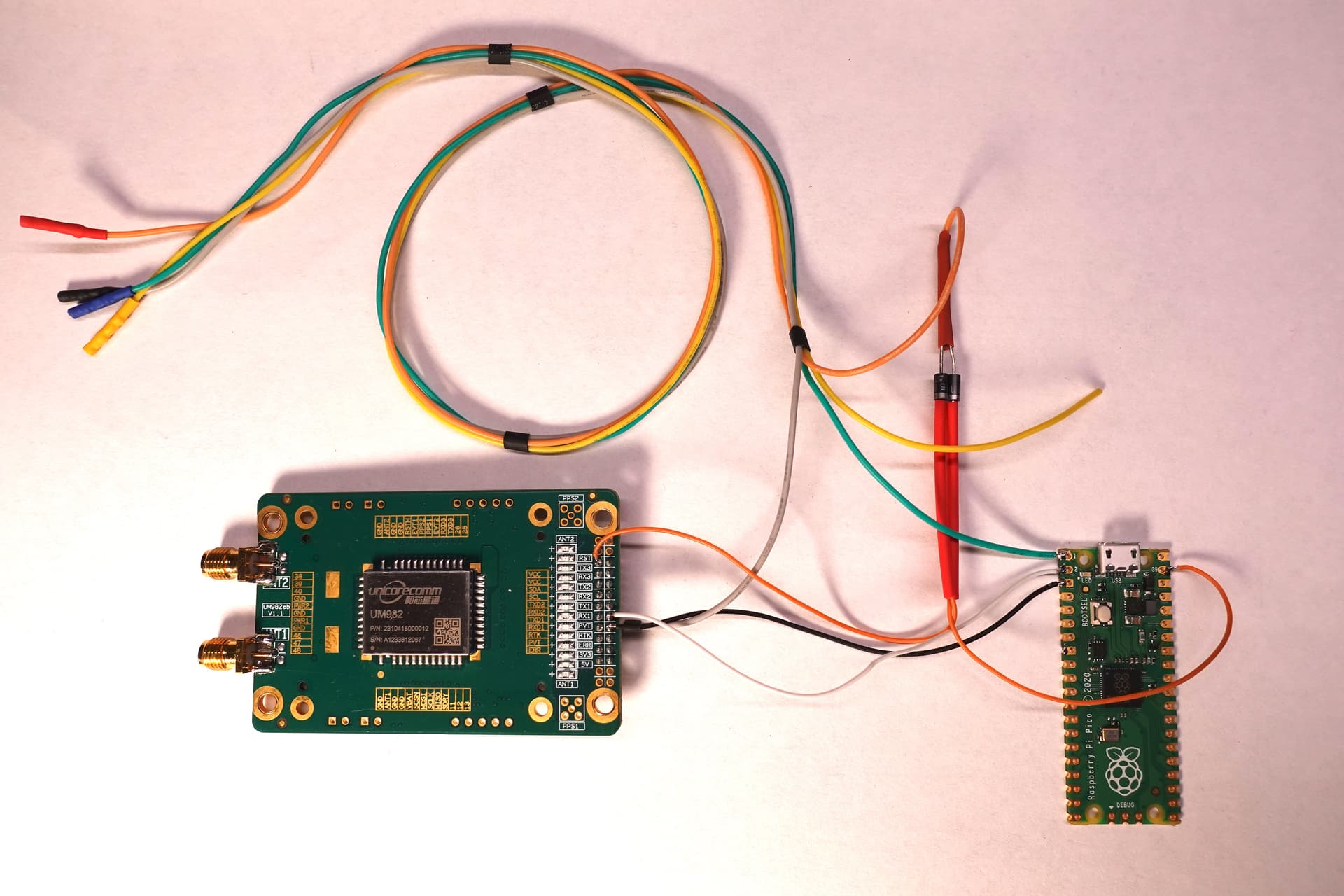

Greetings to all KRAKEN users. I have finished the DATHFK experiments. Everything is working fine for me at the moment. Unfortunately, I do not have the necessary programming qualifications for Linux and Python, and therefore an intermediate microcontroller is used in my device to create a modified NMEA message. To do this, I chose raspberry pi pico RP2040. Before publishing all the files for DATHFK, I suggested to repeat the build and test my device to a Kraken user from the USA. If everything goes well, then by the middle of September 2025 I will publish my files for everyone who wants to replicate this device. In the meantime, I went on vacation. Good luck to everyone.

A really working prototype of DATHFK (there are no two GNSS antennas in the photo).
I ordered the parts to assemble the device in a compact form.

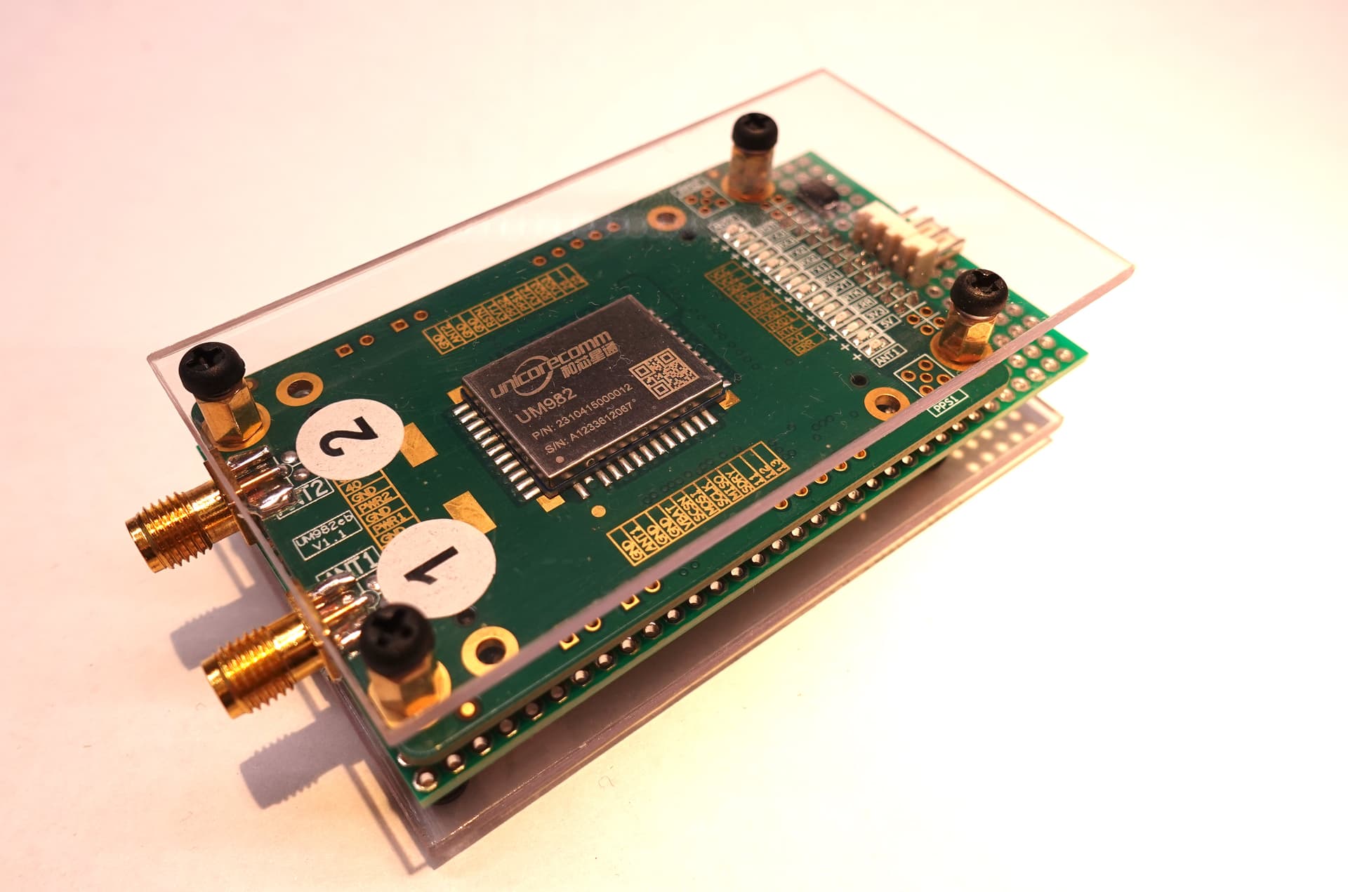

The details have arrived.The assembly to the compact form is finished. It remains to make two transparent lids.

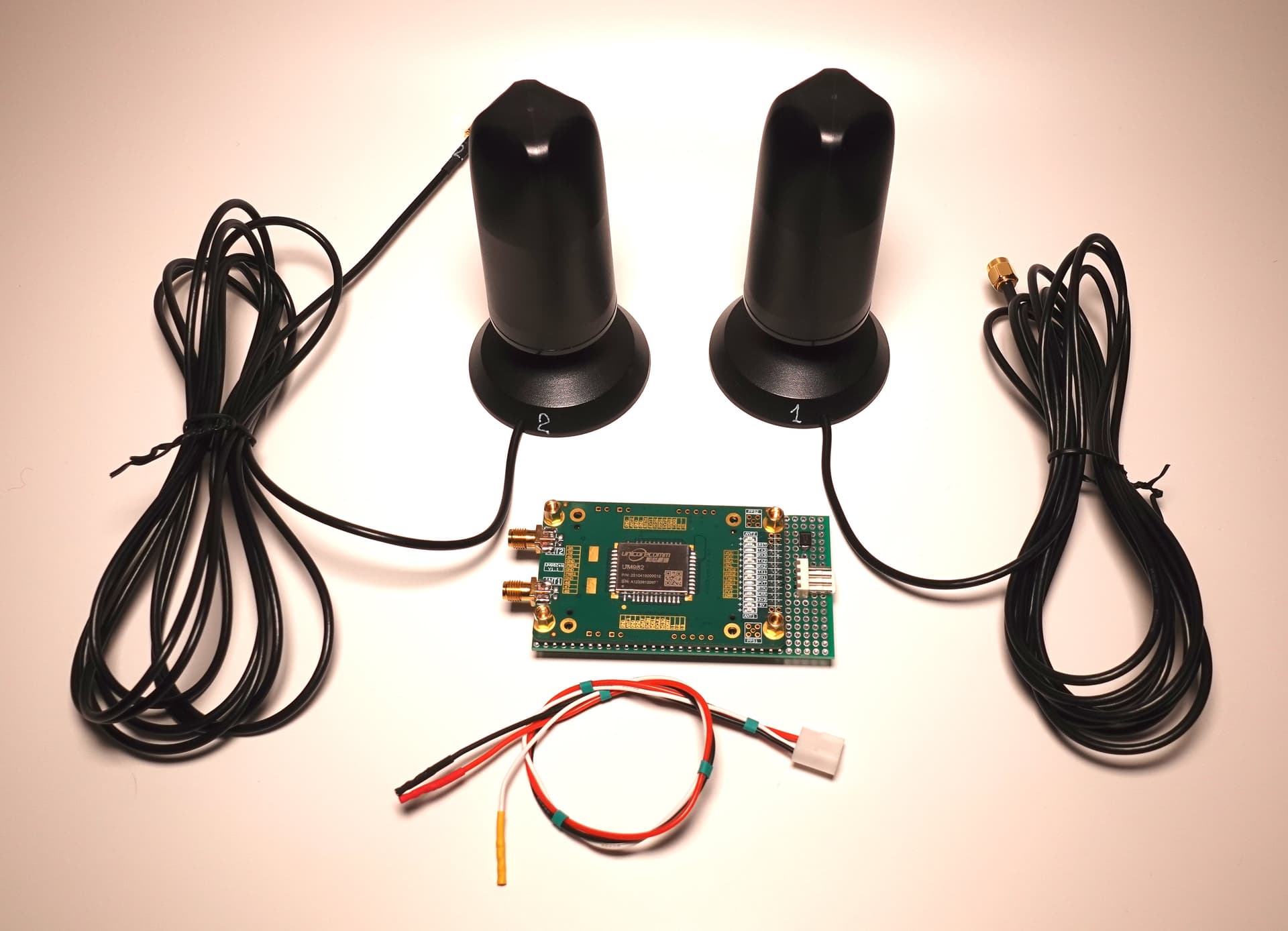

This is the entire DATHFK suite. Two antennas, UM982 module with Pico RP2040 microcontroller, cable for connection to Pi5.
The assembly is finished. I’m not planning any hardware changes yet. The program is also completely satisfied so far. I’ve solved the problems with HEADING for myself.

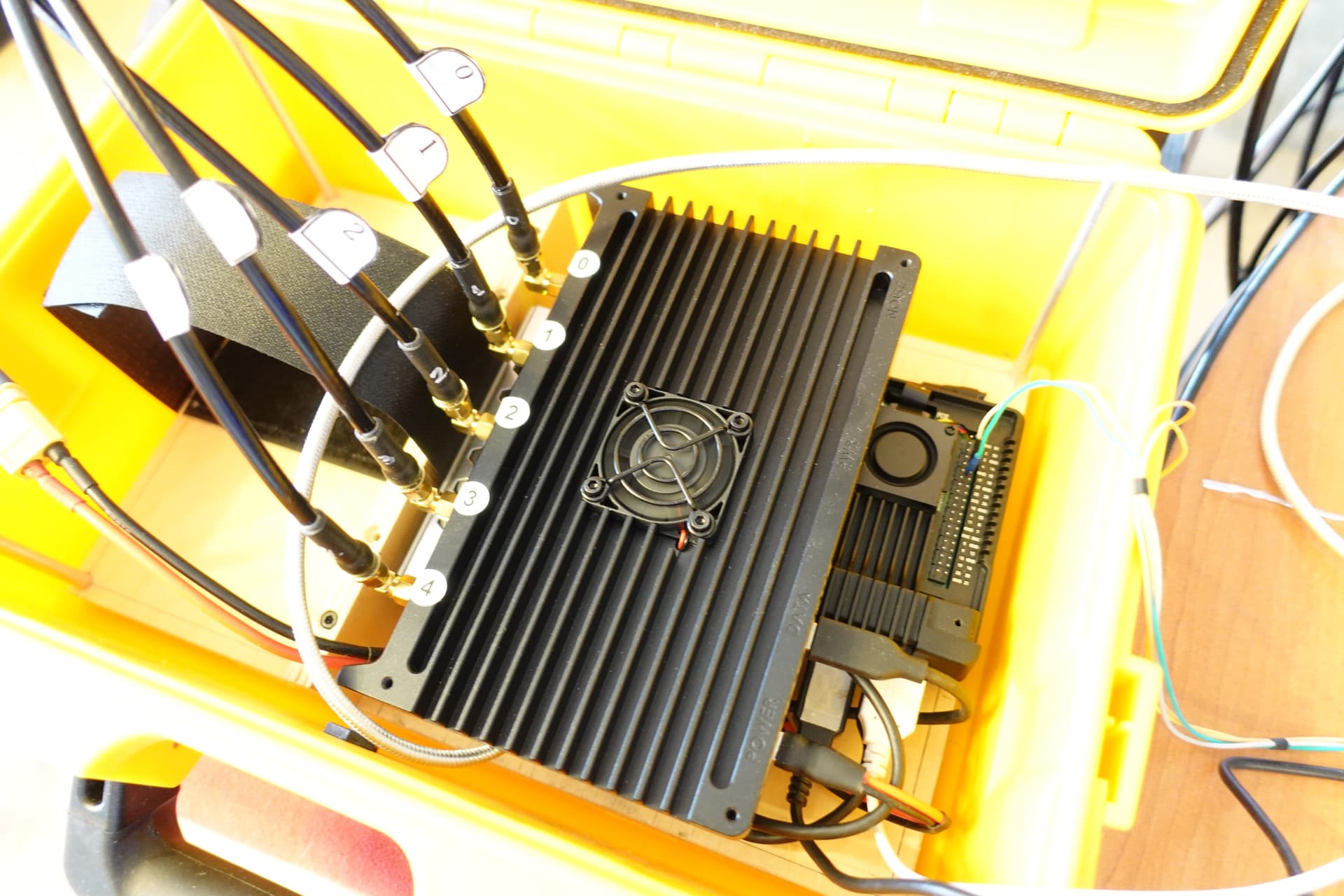

I’m the “USA Beta Tester” for the DATHFK, and I am thrilled to report that it works. What it does is use two GPS antennas; one determines the vehicle’s location, and the other determines the heading or direction the vehicle is pointing. While the Kraken app does an excellent job of this when the vehicle is moving, after you come to a stop, it loses its bearings, and either starts randomly jumping around, or it defaults to pointing north. Because the Kraken app plots the bearing on the map in relation to the direction it thinks the array is pointing, any errors in the array direction lead to corresponding errors in where the app plots the signal as being.
The DATHFK solves this problem, and gives you an extremely accurate (1/10th degree) heading all the time, moving or stationary. I leave my Kraken running in my vehicle from 8am to 8pm, even while I’m at work. When stationary, the direction/heading data is rock solid.
I’m hunting a person who is mobile, with a low powered transmitter, and who is active at random times from very different locations. I drive around, stop, and monitor over and over again. Before having this, every time I parked my truck, I would have to get out my phone and a map program to get my Lat/Lon coordinates, and then get out of the truck to take a compass bearing for the direction it was facing, and then enter these readings into the Kraken app. For places I went on a regular basis, I kept notes, so I didn’t have to take new readings every time, but this meant that every stop required several minutes of time setting up the Kraken, and I often made 5-10 stops in a day.
