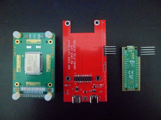

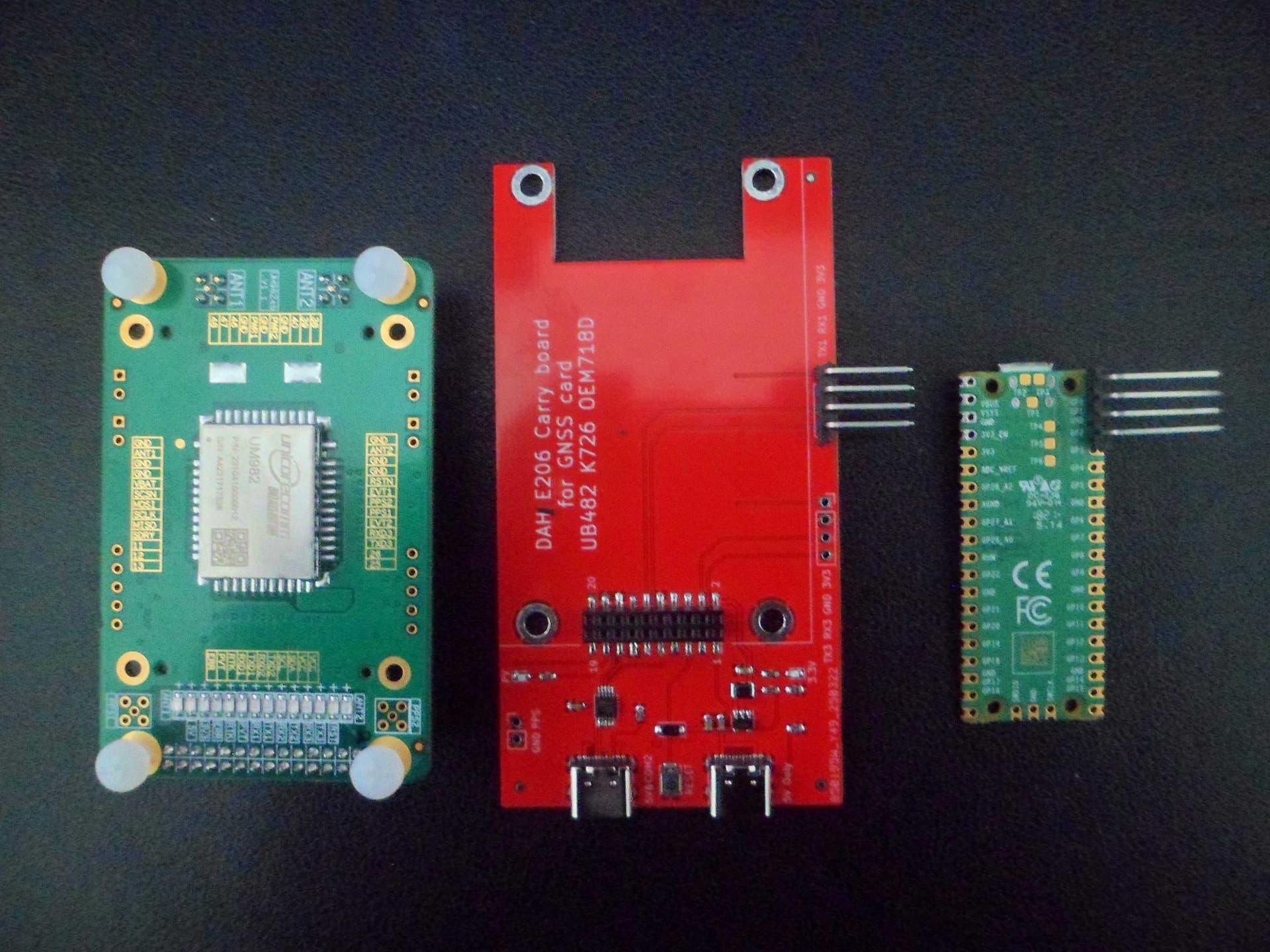

Once again about heading
Above: On the left is the UM982 GPS board, center is the Carry Board that mounts the UM982, and on right is the Raspberry Pi Pico and takes the GPS signals and sends them to the Raspberry Pi5.

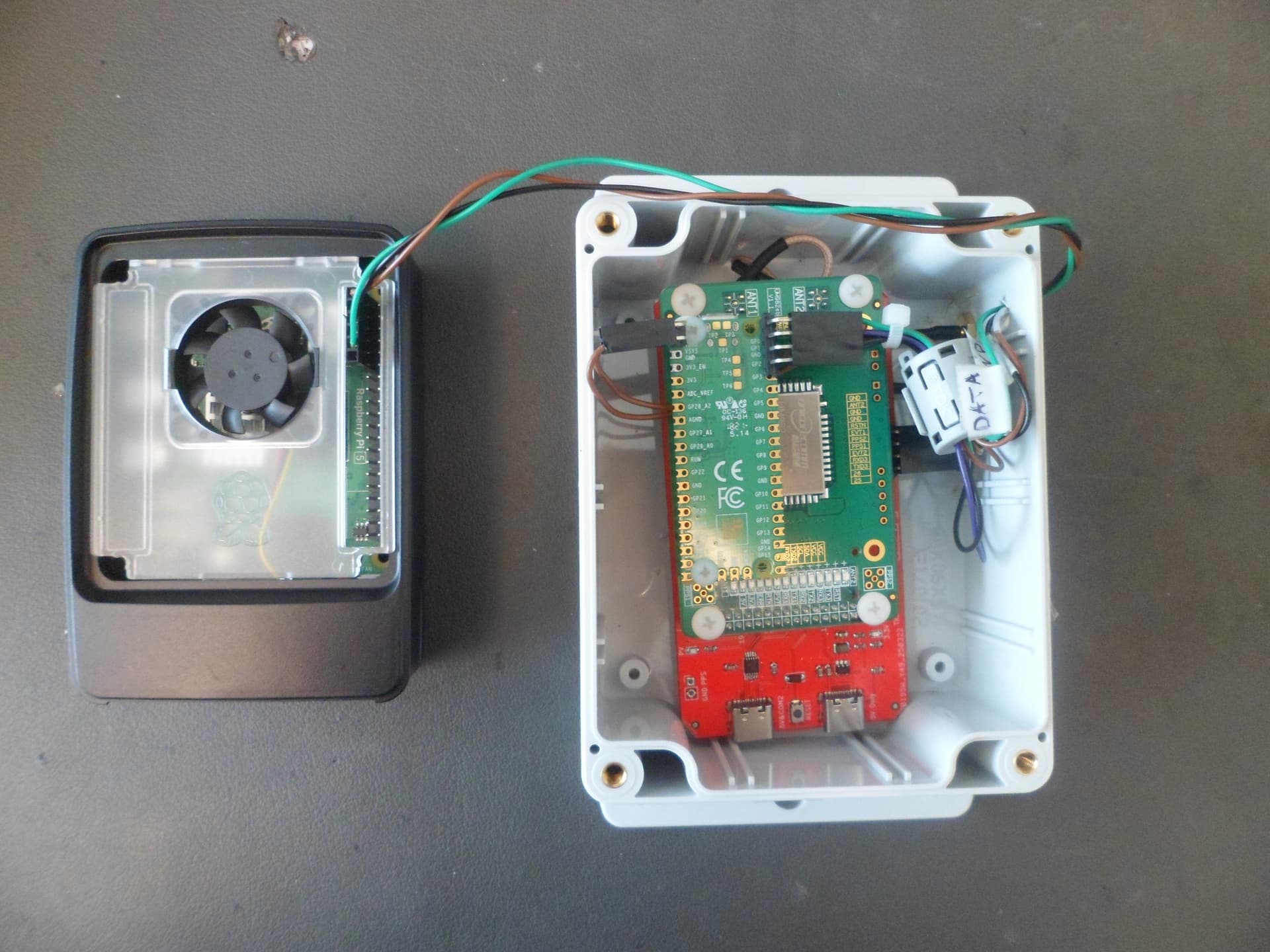

Above: Here is the RPi5, and the UM982 and Pi Pico in their enclosure.

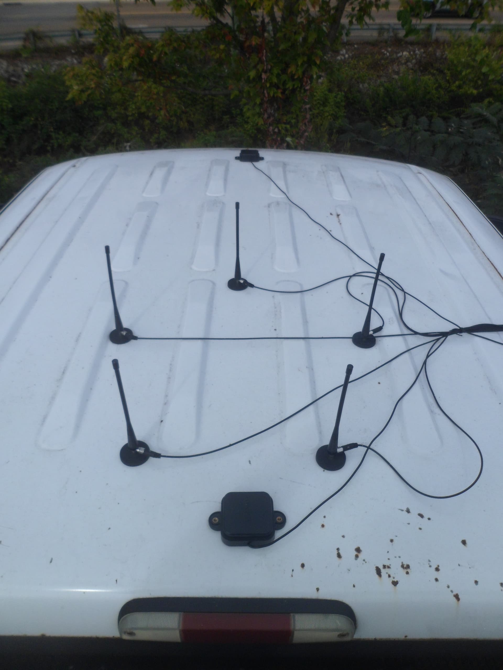

Above: The master GPS antenna (location) is to the rear of the roof, and the slave antenna (heading) is to the front.
