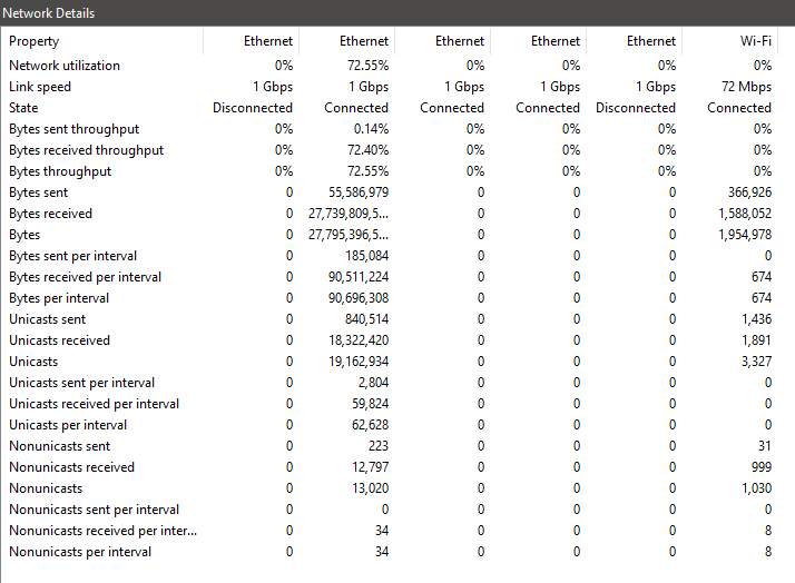

How fast is your ethernet connection? It needs to be at least 1 gpbs without too much other network traffic to stand a chance.
My network has no other traffic but GNU Radio still can’t connect to Heimdall on Pi.
  • Ethernet: 1 Gbps, no other usage
  • Pi: Heimdall running, port 5000 listening
  • Config: Already set to “eth” in ini file
  • Issue: This used to work randomly after power reset of both receiver and Pi, but now even that doesn’t work anymore
What’s the network configuration issue? Thanks!
