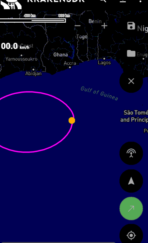

Faced strange problem with android app version 3.6.9(previous version worked fine.) As usual prepared kraken for DF with known transmitter, after enabling Direction finding nothing apeared on screen

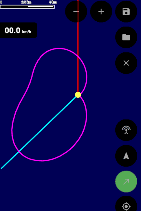

When i use center location function, location changed to coordinates: 0° 0’ 0.0000’’ N 0° 0’ 0.0000’’ E and i saw visual evidence of DF function to be working

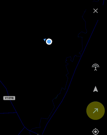

When zoomed out map i can see that app has my current location and heading, but all data is being to be displayed at coordinates: 0° 0’ 0.0000’’ N 0° 0’ 0.0000’’ E .
I changed heading from GNSS to Compass and same results, i also check location settings for app and it seems not to be the problem.
Coordinates: 0° 0’ 0.0000’’ N 0° 0’ 0.0000’’ E seems to be default location when app is launched, after few seconds app receaves real location. Any ideas?
