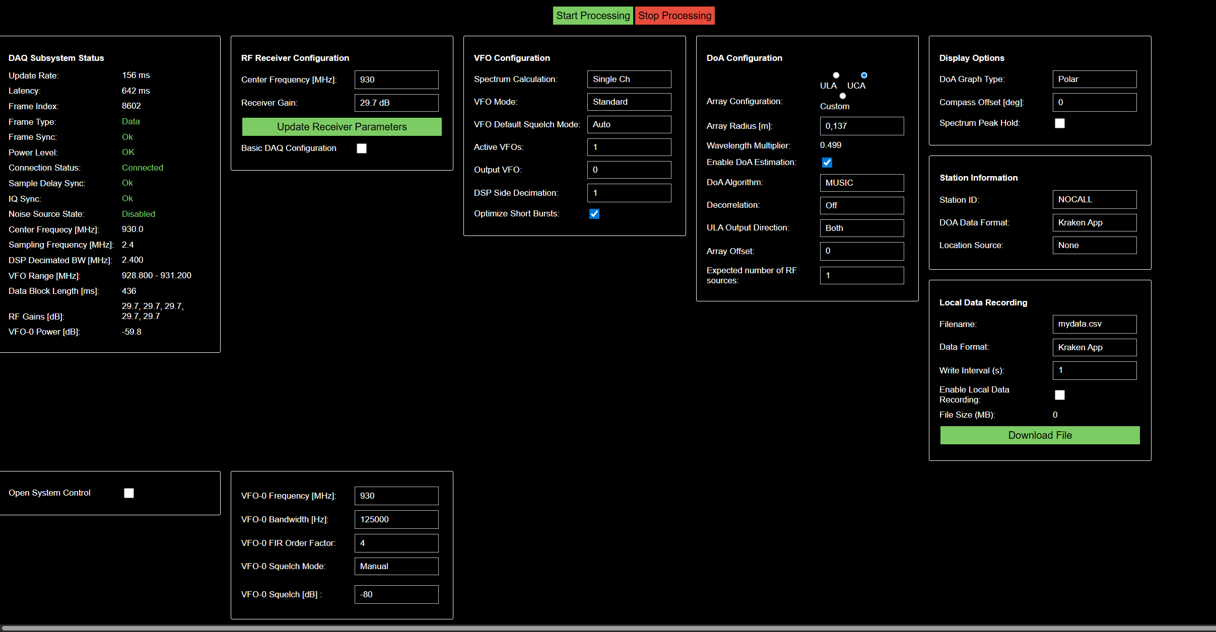

Hello, I set up the transmitter to 930 MHz, I need a range from 900 to 976 MHz, but I can not find in the GUI where this is configured, now the range is VFO Range [MHz]: 928.800 - 931.200
I change VFO-0 Bandwidth [Hz] but VFO Range [MHz]: does not change

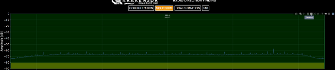

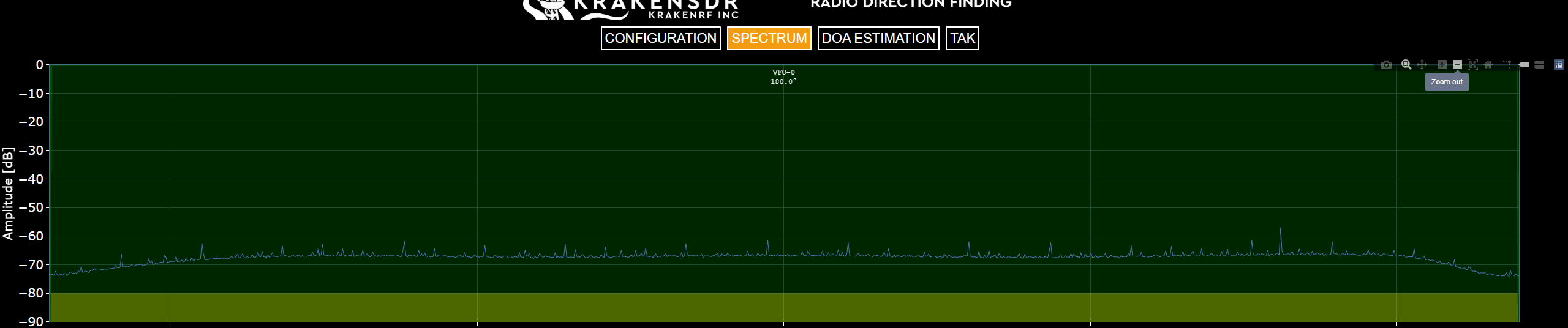

also I can’t zoom out the graph on the spectrum page, as soon as I press zoom out it goes back to this range
rtl2832u sample rate 3.2 MHz, the bandwidth cannot be made wider

The max stable bandwidth of the KrakenSDR is 2.4 MHz, you cannot go wider than this.
