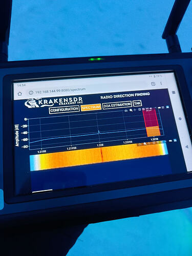

Hello, after turning on the range in the spectrum itself shifts to the right position instead of the center, what could this be connected with? In the photo we see the transmitter turned on at 1220 MHz

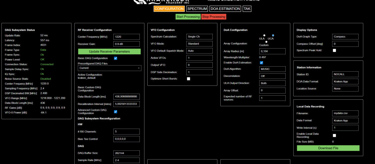

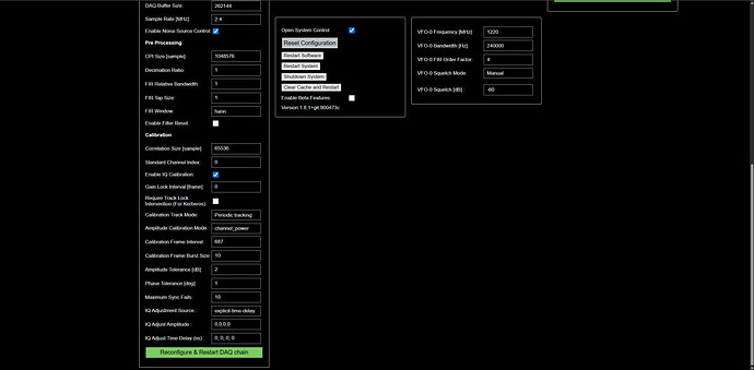

Kraken configs
If you click in the spectrum, can you move the IF tuning bar?
