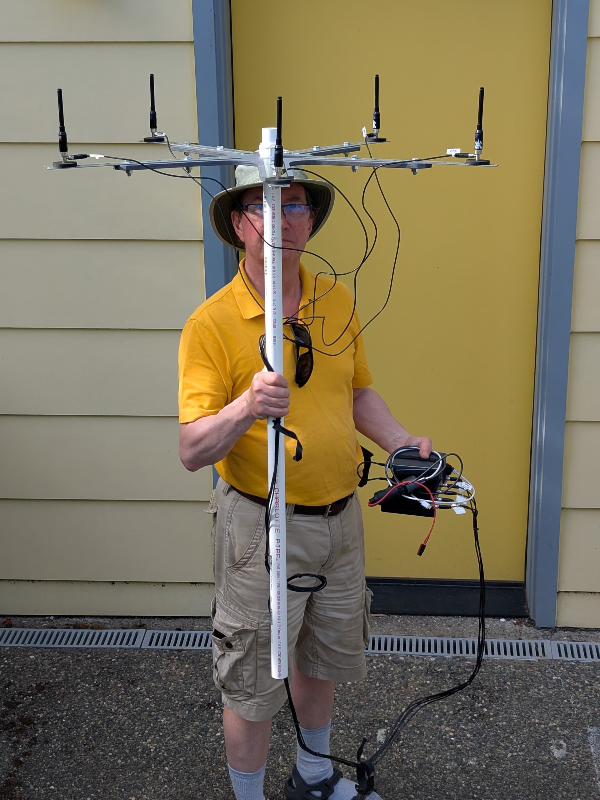

Imagine someone carrying a Kraken like this:
