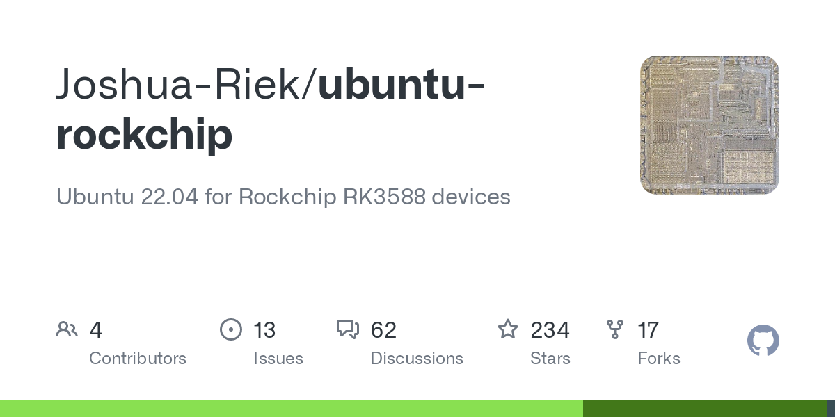

krakenRF didnt work, the shared ubuntu worked
the ubuntu image Releases · Joshua-Riek/ubuntu-rockchip · GitHub
should enabled me to boot from SD or USB (krakenrf on SD / usb ) didnt load
