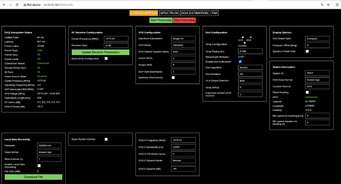

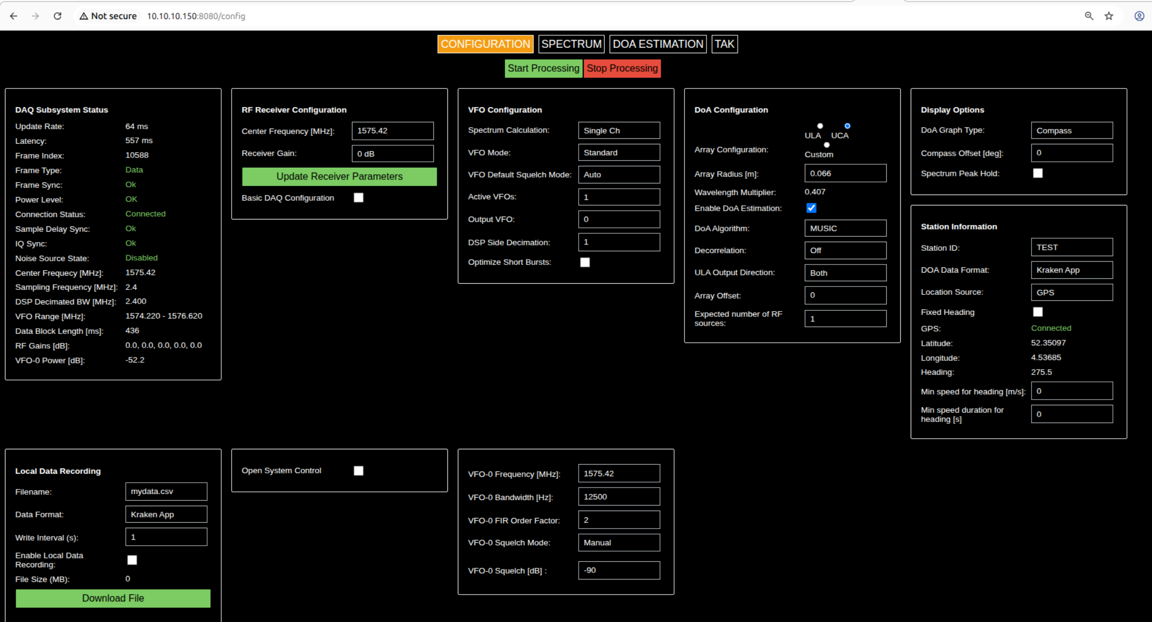

Here is a web UI screenshot in case it helps. Location is generated, constantly moving at 10 m/s with mostly real gps data.
I plan to test with a standard USB GPS to make sure its not the data I’m streaming to GPSD thats messing it up. When I view my GPS with cgps, I see valid gps data, but it says ‘seen 0 / used 0‘ satellites, I assume this is because I don’t stream each satellites info (ID, SNR etc), because it’s not immediately available via mavlink.
