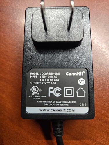

Can I please know what power supply you are using? (model number, or a photo of the specs would help).
Presently a canakit.com per attached.

The power supply looks good to me. I’m assuming it’s dedicated to the Kraken, and not powering both the Pi and Kraken together?
Correct. Two individual identical supplies. Will test a 3 ft cable tmw. After that I’ve run out of ideas.
Replacing the USB A to C cable with a 3 footer allowed everything to connect and run perfectly. Lesson learned. Thanks again for your assistance. Now we begin the mobile testing.
