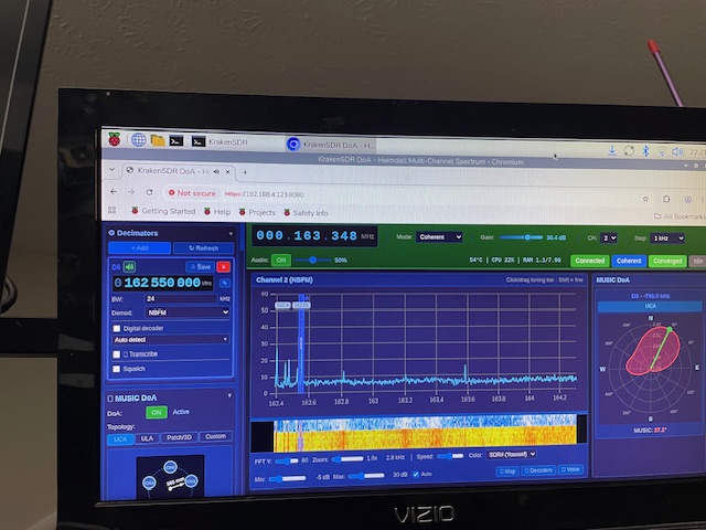

V2 10/23/26 pull. Boot rpi5, launch browser (chromium on host rpi) using https://…, hmi appears OK with frequency and audio button=ON. No audio is heard. Click audio button OFF…ON, audio plays OK.
Note: in my browser, connection to ksdr gives “not secure” warning. I select “proceed anyway..”, browser connects OK but indicates “Not secure” in the URL box (see photo).
You’ll need to click anywhere within the interface for the browser to activate the audio. This is just how the browser works. You don’t need to specifically click on the audio on/off button.
Unfortunately, it will always show ‘not secure’, because we have to give it a locally generated certificate to use https. And https is required for audio to work in the browser, due to some security measures of browsers.
