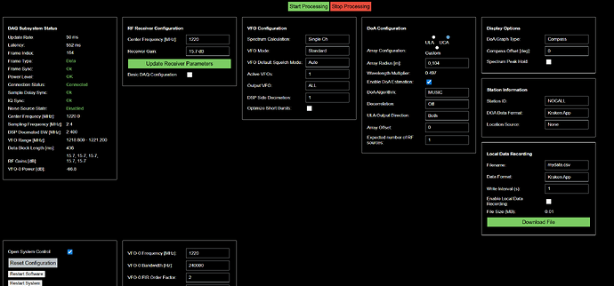

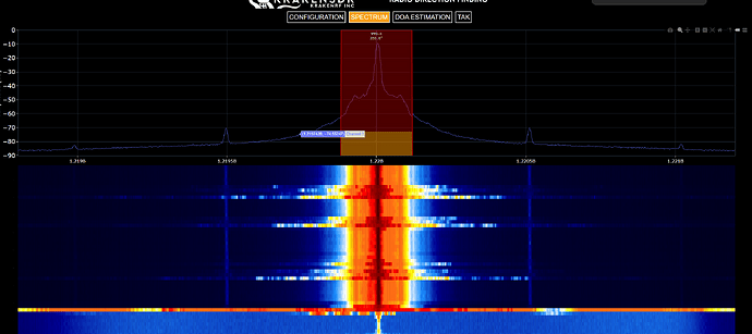

Another problem, when starting it always shows either 1 degree or 280, the spectrum is always red, but as we can see there is a signal, I just start it with the script kraken_doa_start.sh, what could be the problem?

maybe there is a noise threshold setting somewhere
UPD:found it
VFO-0 Squelch Mode: Manual
VFO-0 Squelch [dB] : -80
Yes according to your screenshot you are squelched and hence no data is being provided. Setting the squelch for your signal level will fix it.
