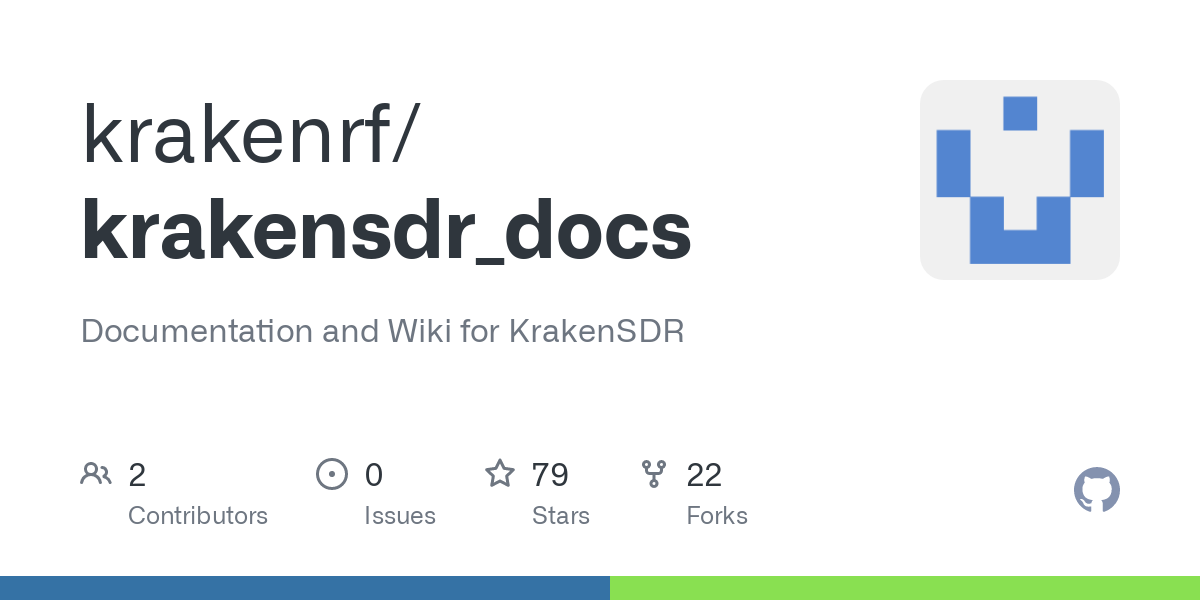

The KrakenSDR RDF app on the Google Play Store will work with your KerberosSDR.
This page on the wiki describes the process of using a KerberosSDR with our KrakenSDR software.
Syed
