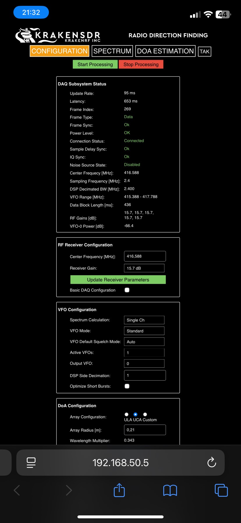

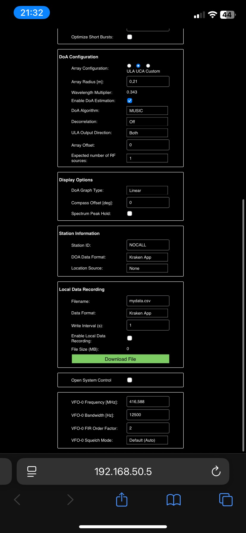

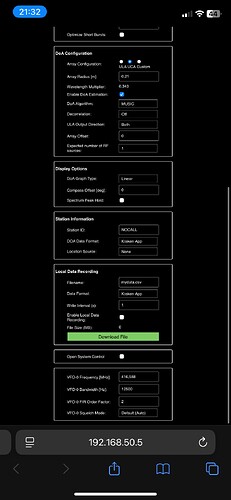

We connected the KrakenSDR and Pi and powered them up. We connected via Wi-Fi and went into server settings. We connected our five antennas. However, when we send a signal, it doesn’t show up at all. We’re sending our signal at 153 MHz, but we’re not getting any response. We initially noticed it was working in the status section, but the map wasn’t. When I pressed Start Processing, everything started showing up as red and empty. Could you help? Thank you.
Can you post up some screen shots from your device showing the Kraken settings and Server Settings?
All your numbers and settings look good to me.
With the RF Gain set of 15.7 you might miss some weaker signals; chasing 5 watt transmitters in the 462 MHz range I set my gain to about 32. You have Squelch set to auto, but if it isn’t “autoing” properly, it could block out too much signal, so see the next step.
