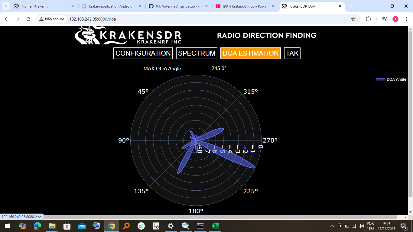

Same problem here. Some data from spectrum and DOA stimation, but my map nothing is showed. If I click on DOA arrow only a message: “No estimated point yet”.
Android app version 3.6.9
My cellphone is a Xiaomi POCO X3 NFC
I tried on a iPad but the same issue on it.

Forget about it.
I put it to work properly.
Things that I do wrong:
The antennas cables I put correctly on antennas, but wrong on the krakensdr
Try to get some data with the car stopped😶🌫️;
And some others things that makes me very shame to mention here hehehe.
