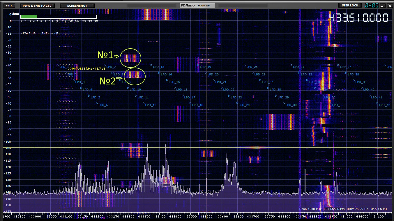

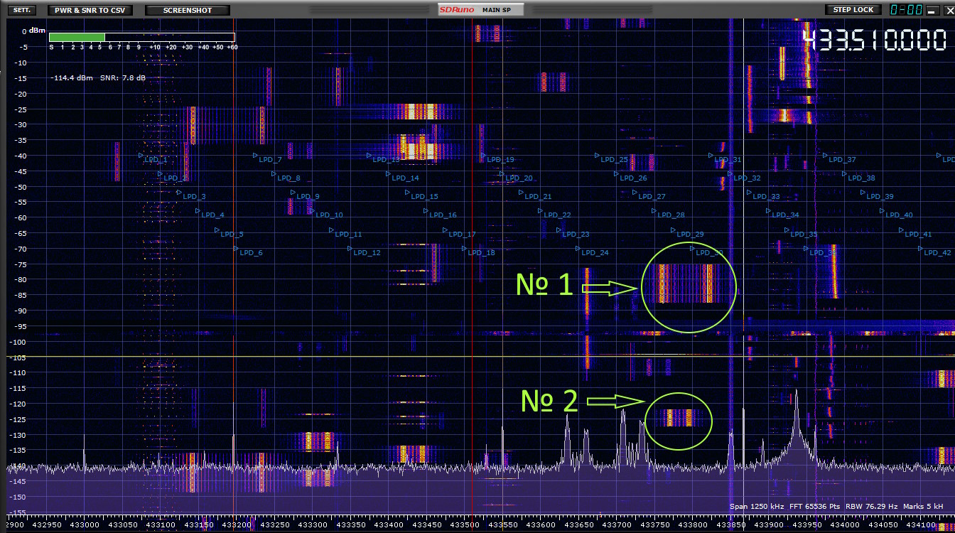

This topic is very relevant! The human voice (legal or not the transmitter) can be determined by ear. Sometimes illegal digital transmitters (for example, LoRa) work with a very wide bandwidth, which partially or completely overlaps with another similar transmitter in frequency. But they do not work simultaneously. I am attaching two pictures with such cases.
It is possible to separate one of them from the other only on the receiver’s SDR waterfall by their characteristic pattern.
