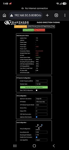

I recently got a kraken with the antenna set. Downloaded the Pi image an successfully I nstalled a Pi5 16GB

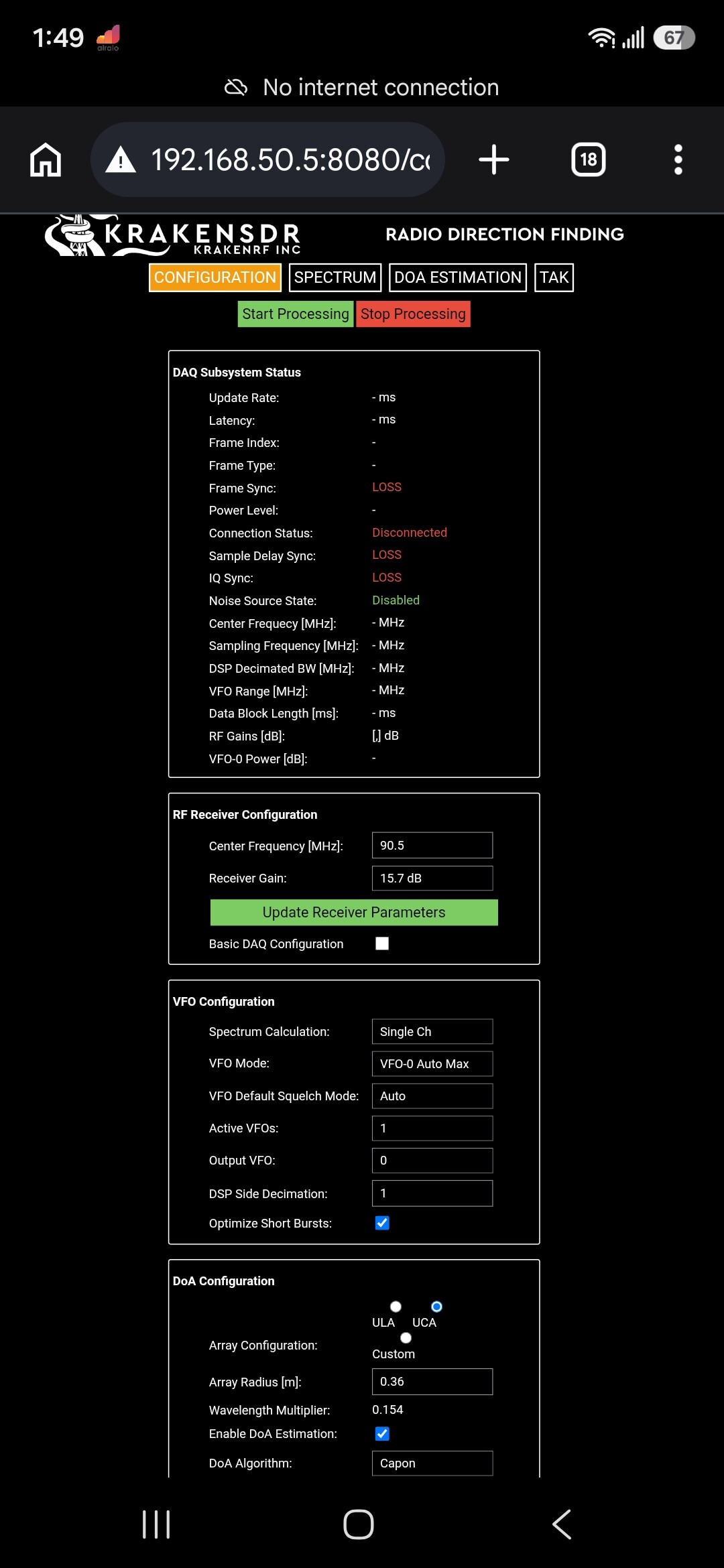

Connected it to a hotspot on android - trying to use/test get the following
It just does not go past this status?
Any support would be appreciated.
Thank you in advance,
Basically, the RaspberryPi is not connecting to the Kraken. I find that I need to plug the Kraken in first and give it a minute or two to boot up before powering up the Pi.
The most common issue when the Kraken doesn’t connect is that a poor quality data USB cable is being used, or the power source that you are using is insufficient. Do you have another USB cable you can try?
