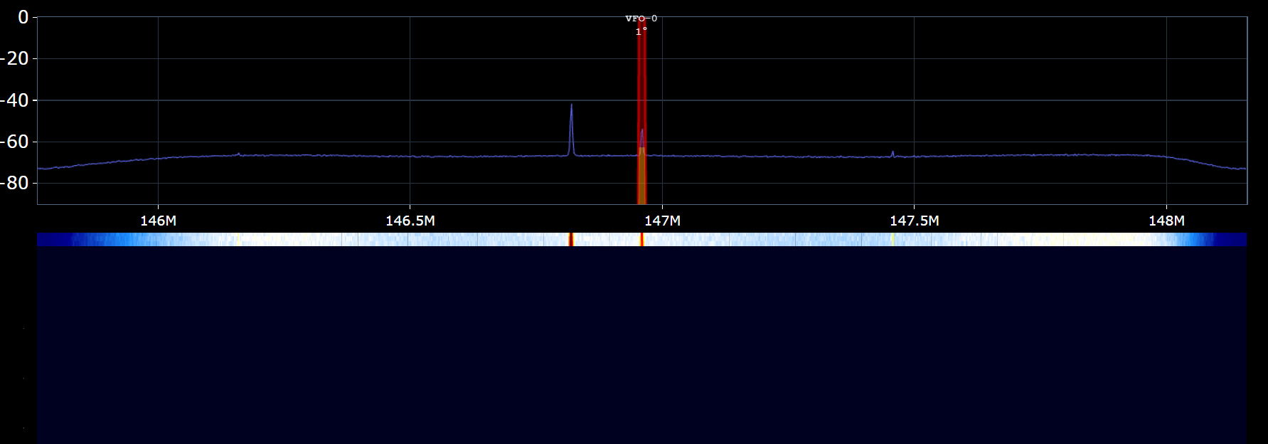

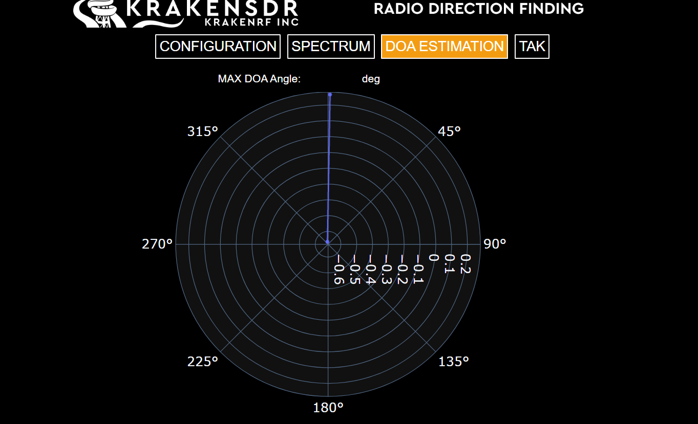

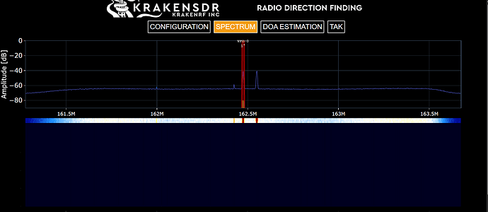

alright while out on a hunt my Kraken stopped estimating DOA… Not sure how to fix, ive restarted multiple times with no fix. any ideas?

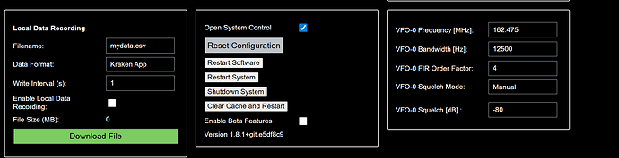

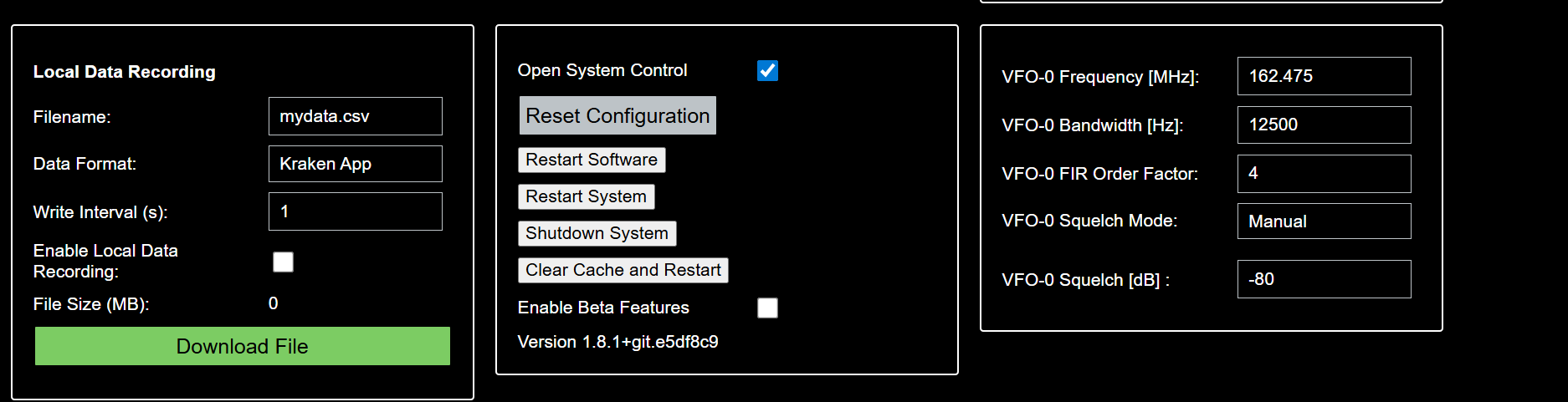

From the screenshot I can see that the VFO is red, indicating that the squelch is active. Could you please double check what you have set for the squelch settings?
Yeah Carl, I had it all set on auto like ive always ran it. I even set the squelech to -80 so it would hear everything and i had no DOA Estimation

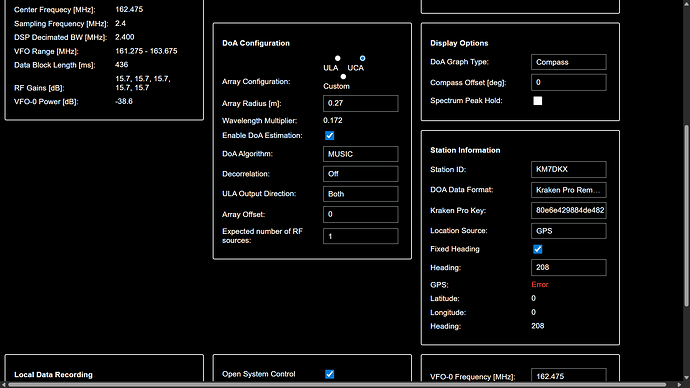

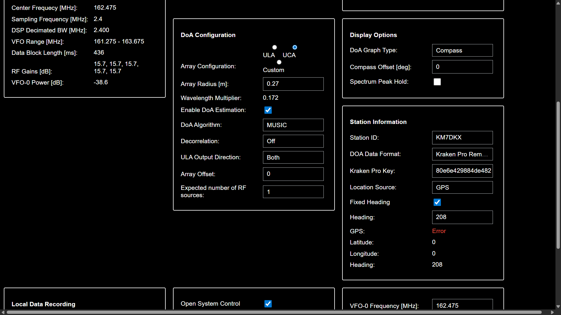

Can you please post a screenshot of the configuration tab?

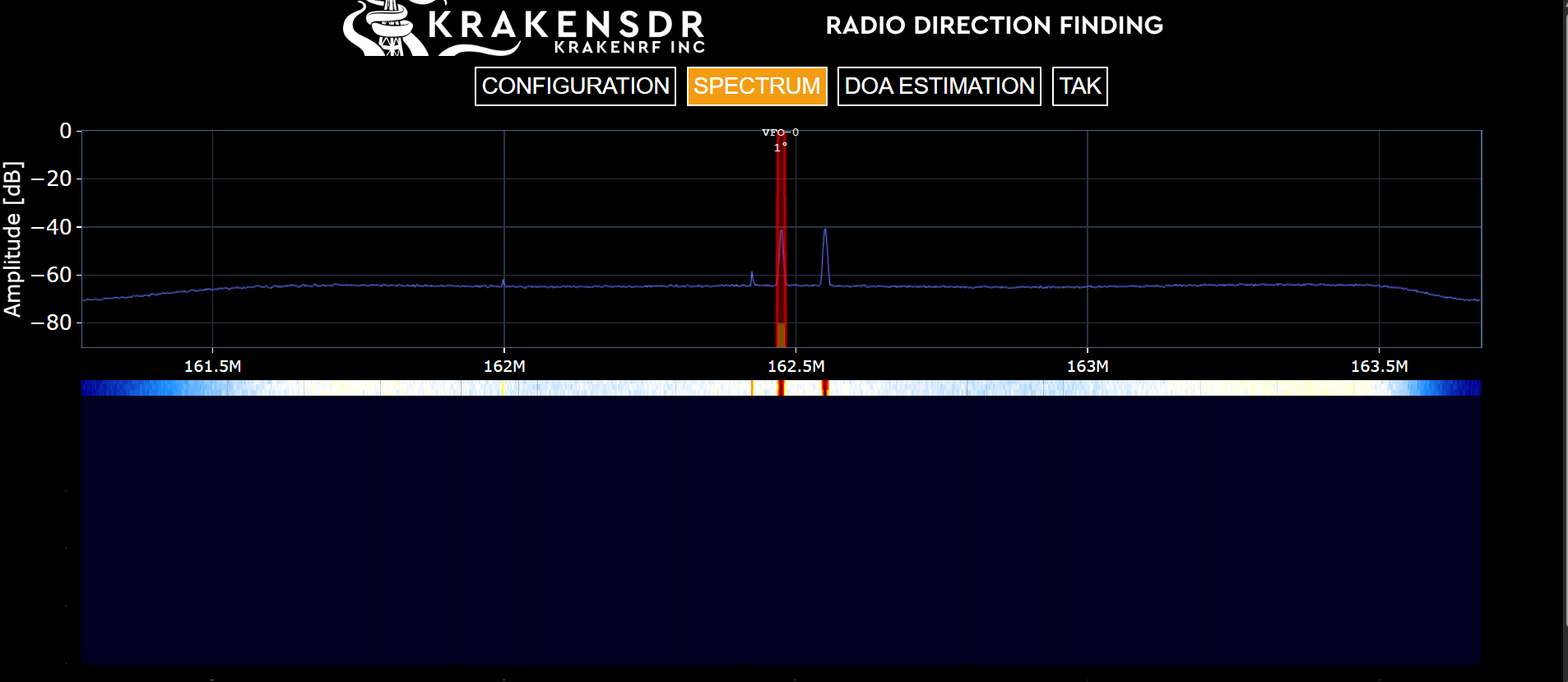

Im still running into this issue where it sees a signal but for whatever reason can’t hear it or track it.

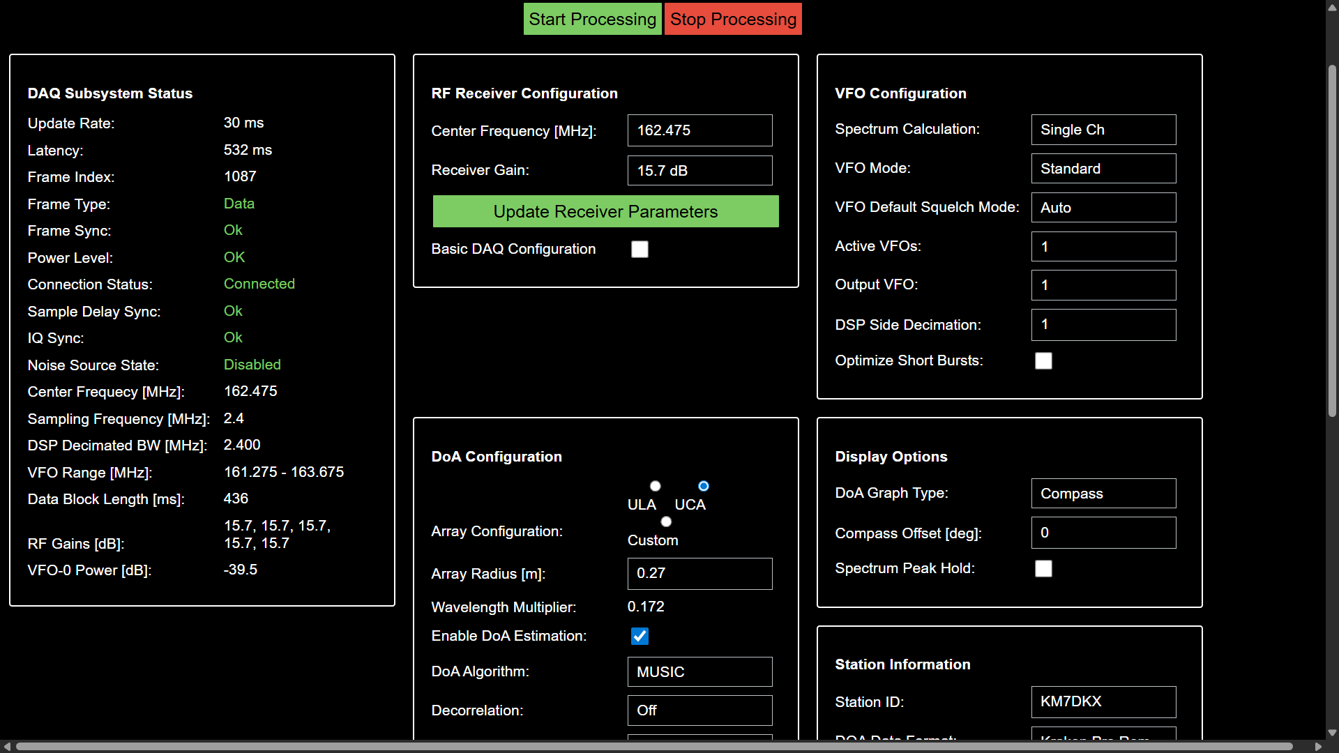

If you are seeing all green text on the DAQ Subsystem Status, then the cable is fine. Could you test on your bench with a beacon (just not too close or high power)?
It is strange that you have signal, and no squelch, but are getting squelchjed.
Please try two things:
  1. Press the Clear Cache and Restart button under system control
  2. If that doesn’t help, please try a fresh install of the software.
