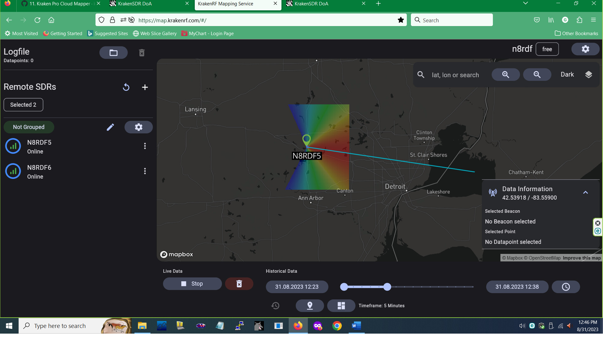

I have two KSDR operating on v1.6.1 and both functioning correctly in the android app. Both are configured for Remote Pro with their respective API keys. Cloudmapper shows both online and “Devices Selected”=2. I am only able to get the first station to appear on the map (see photo). Suggestions? Thank you!

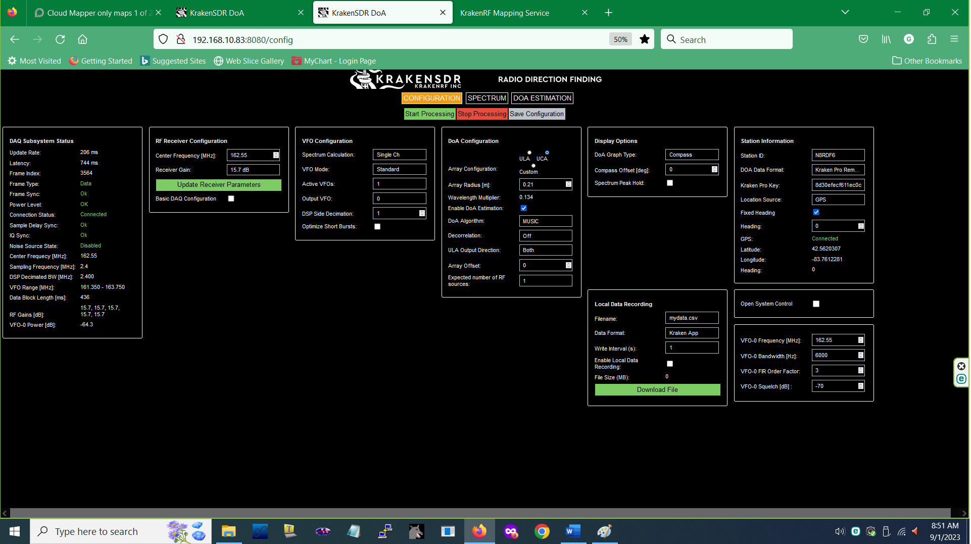

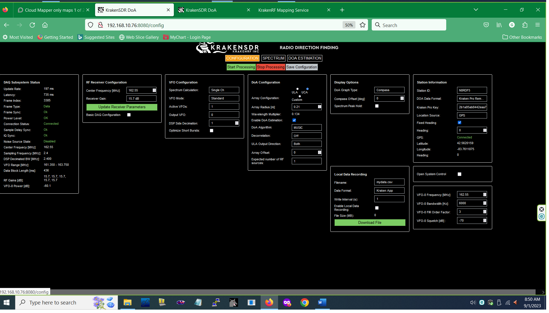

Config screens: (N8RDF6 is the one not showing in cloudmapper)

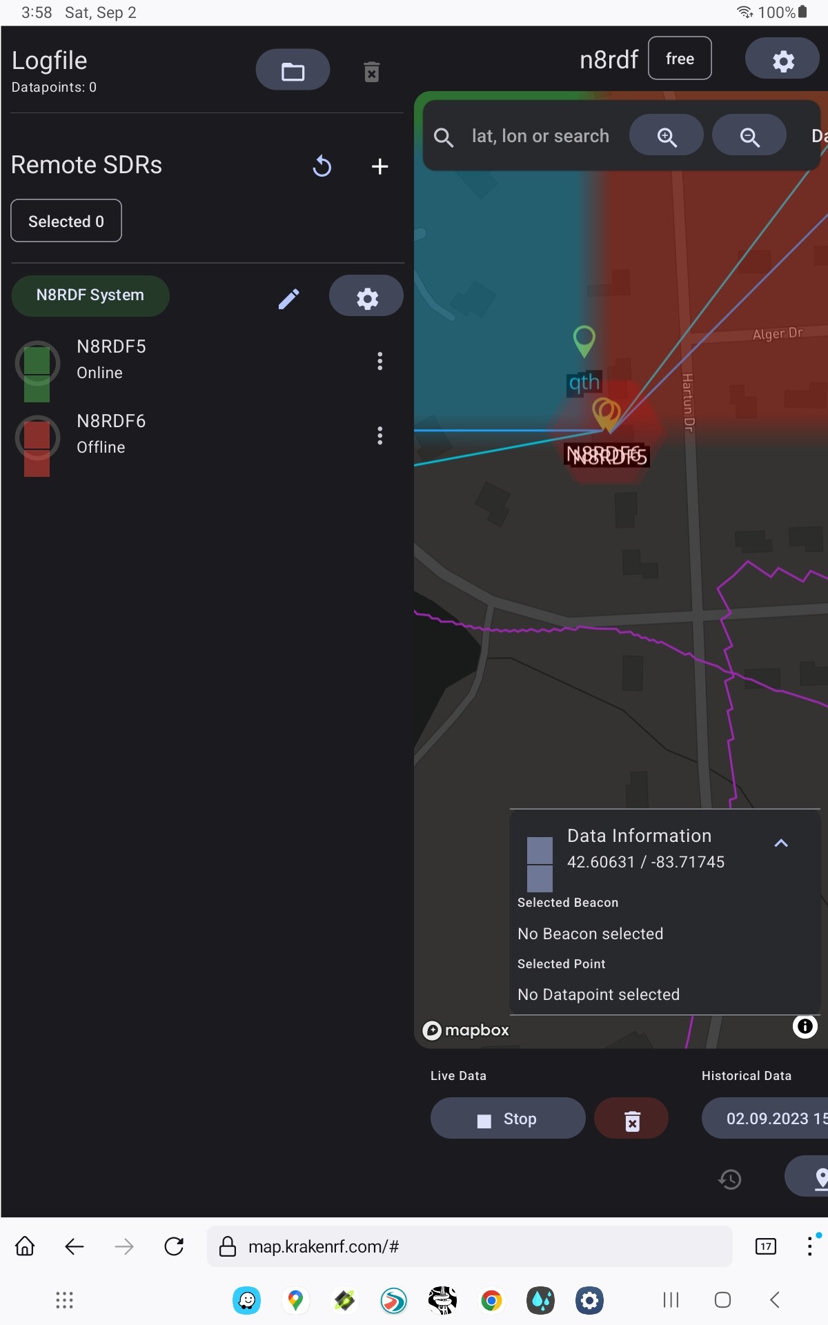

Could you please show a screenshot zoomed all the way in after you start the data feed for the group?
I’m out of town so only have my tablet until Monday. I hope this helps.

Both were working when I left town but it seems n8rdf6 went offline since. I won’t be able to restart it until late Monday.
Upon returning home, I found N8RDF6 still operating and still providing live readings to my pc browser., but cloudmapper showing it offline. My Firefox tab for Cloudmapper was completely frozen, couldn’t be refreshed and had to be closed and reopened. During the recovery process The two station tabs were still functioning and showing live readings. N8RDF6 is on the same internet connection as N8RDF5, which never went down. Refreshing or restarting Cloudmapper did not bring N8RDF6 back online. Neither did changing N8RDF6 System Config from Pro Remote to Pro Local and back.
A System Restart brought N8RDF6 back online so both are now showing live data in Cloudmapper.
