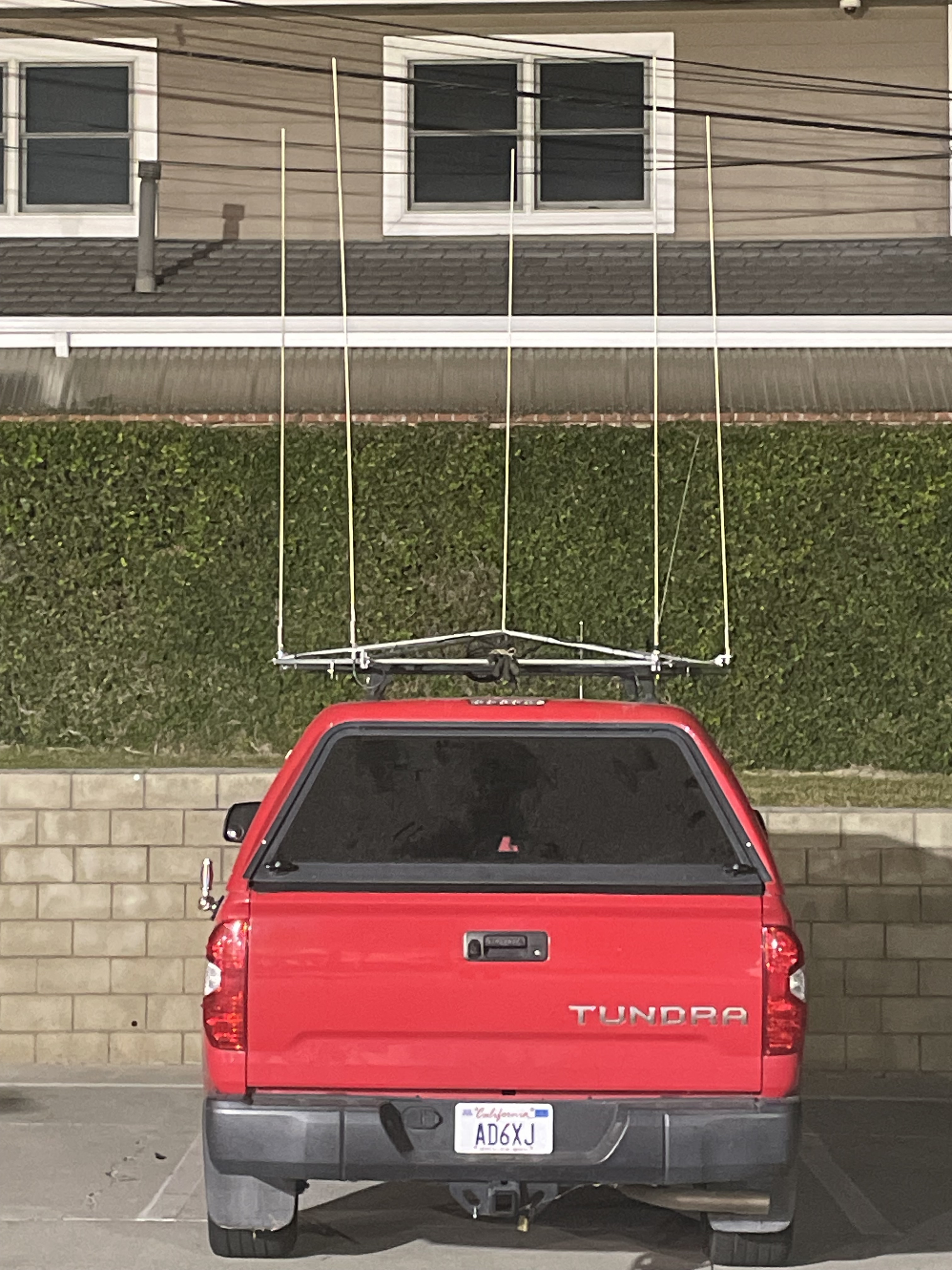

Curved metal eh?
I have a slab of glass
It’s a pain in my glass
Yeah… definitely have to make something for that!!!
