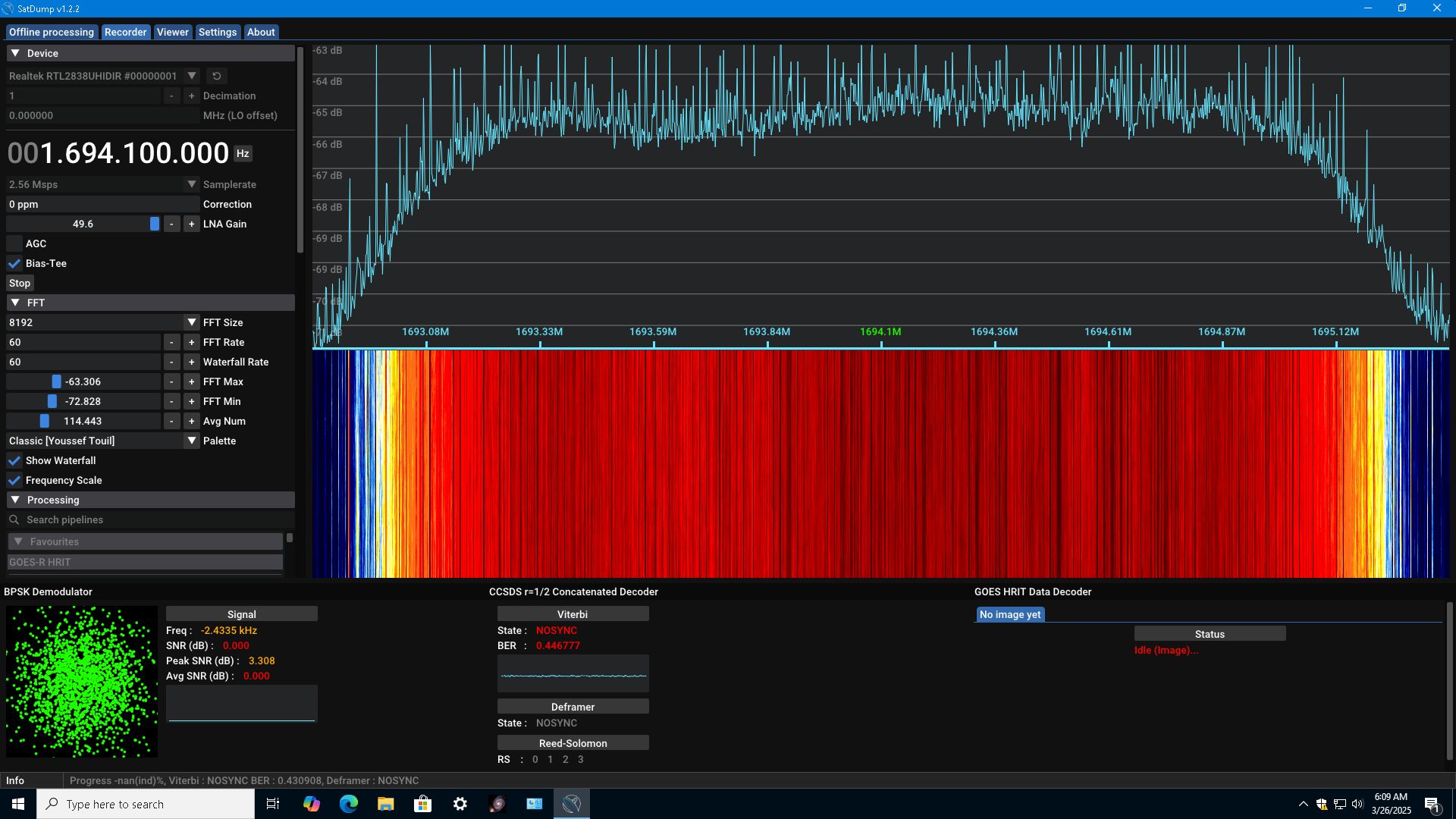

Well I checked everything this morning while it was dark and the noise spikes are still present. Next I rotated the dish in AZ in the general direction of GOES 18 (218deg) and the noise pattern still present. Next I aimed it directly at my house which is two story and noise pattern still present and I had to lower the FFT to get the spectrum back in range since it had risen, here is a screen capture of that.
I guess it is a reasonable assumption that this RFI is local since pointing does not matter. Haven’t tried moving the dish assembly to a different part of the yard since I only have 60 feet of active USB repeater to work with.

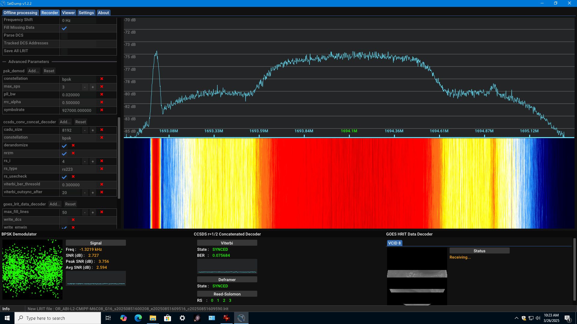

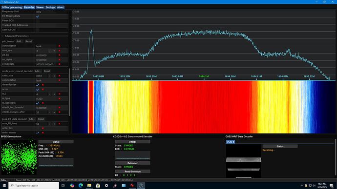

Anyway here’s the screen cap with the dish pointed at the house.
Finally Working!! —AFter trying all kinds of stuff without listing here I ended up relocating the dish 30 feet south and a bit east. Only need to do a little more tweaking position and skew and I think I am finally in business.
