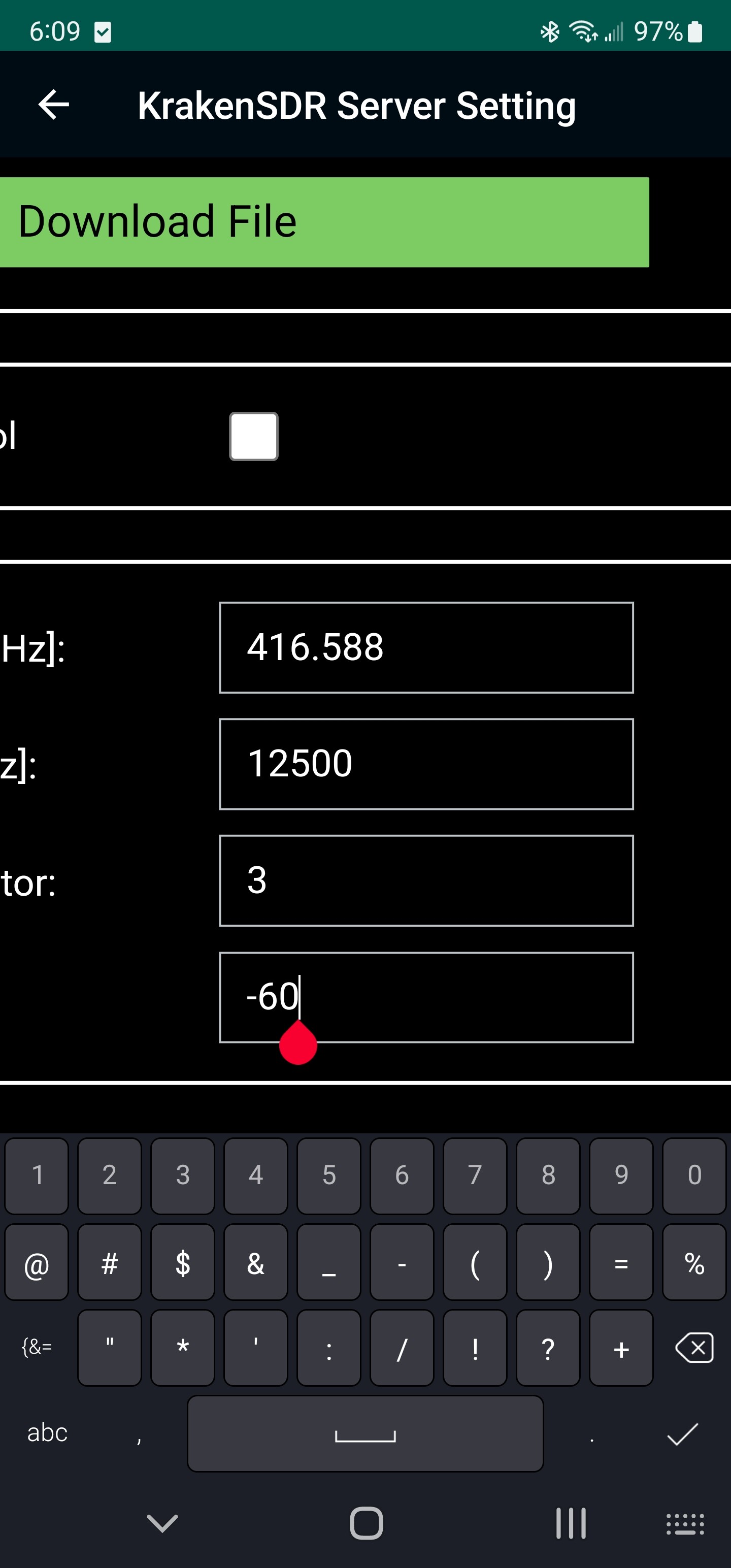

I tried on S22 ultra and a Galaxy Tablet and the keyboard that comes up when I enter the field does not contain a minus sign. It’s like a super limited number only keyboard. What type is used? I was just dealing with this problem on something completely unrelated and found it odd that type=number came up with the symbol/number keyboard, and type=tel is the only one to show a keypad, and even then it showed number related symbols like ±,.()
But the one that comes ip on Kraken has no negative.

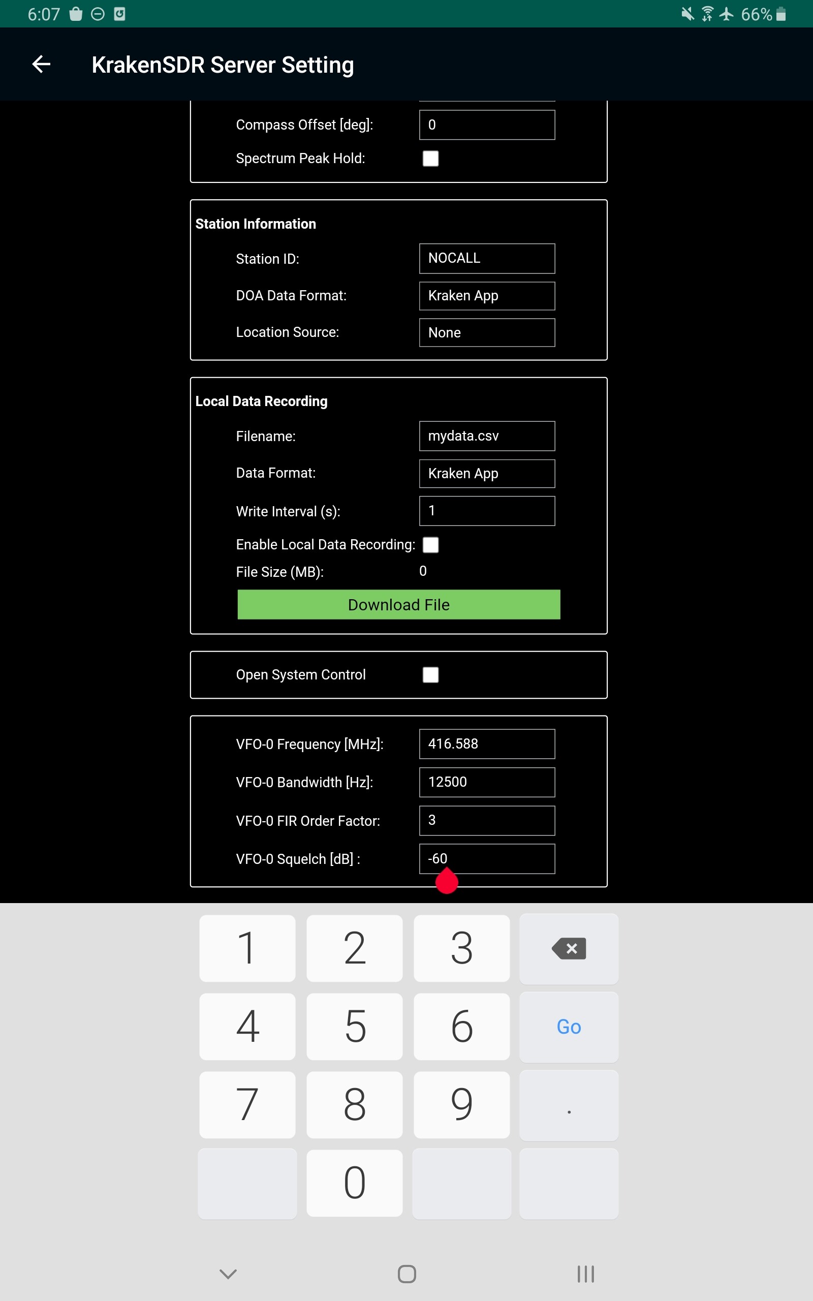

Odd, I know I tried on both devices, this time the S22 worked, but the tablet didn’t. Brought receipts this time…
Tablet Galaxy Tab S5e
S22u (not what I saw yesterday…though that doesn’t make sense…)

Huh weird. I have never seen a numeric only keyboard like that pop up, other than for phone numbers. The standard number type is used, so no idea why it’s pulling up the telephone keyboard on your device.
Do other fields in the GUI also pop up the telephone pad on that device?
Is that the default keyboard on your device or a third party one?
Had the same issue with Samsung a8 tablet until I loaded a 3rd party keyboard. I used Microsoft swiftkey keyboard and it offers full keyboard with symbols
Yeah On my S22u I too have swiftkey. On my tablet its the stock keyboard app.
